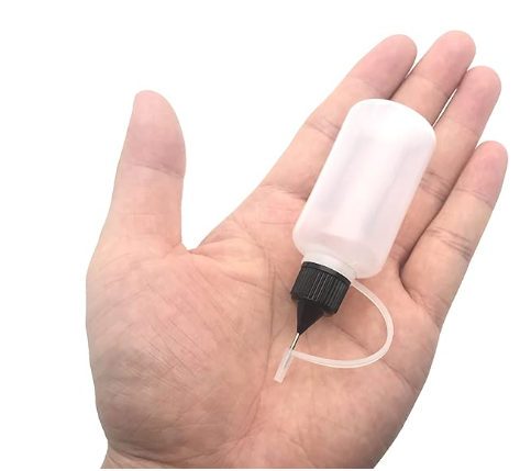

I put some of the oil in a little squeeze bottle with a hypo tube tip. A few tiny drops in the rail grooves and it's good for another month or so or until it makes enough noise to alert me.

I like the gun oil idea. I assume it can be applied without disassembling the rails. I have needle applicators to use the oil with. If you tip the rail upside down there are gaps between the rail and carriage where the oil could be applied to the bearings. Is this the best way to apply?
Yup, you assume correctly...
All you need to do is stick the tube from you oil bottle. in the groove of the rail and apply a few drops. Capillary action will suck the oil into the groove and when the balls run over the oil it will get distributed. You can just move the toolhead by hand to distribute. And of course, wipe off any excess from the flat surfaces, plus a lite oil coating prevents oxidation/rust.
FWIW... My Voron 2.4 just turned 3 years old, and I've easily run 10+ miles of filament thru it. One can only guess how much distance the rail carriages have travelled... All on light gun oil.
You can also pick up some of the little bottles on Amazon for cheap.
