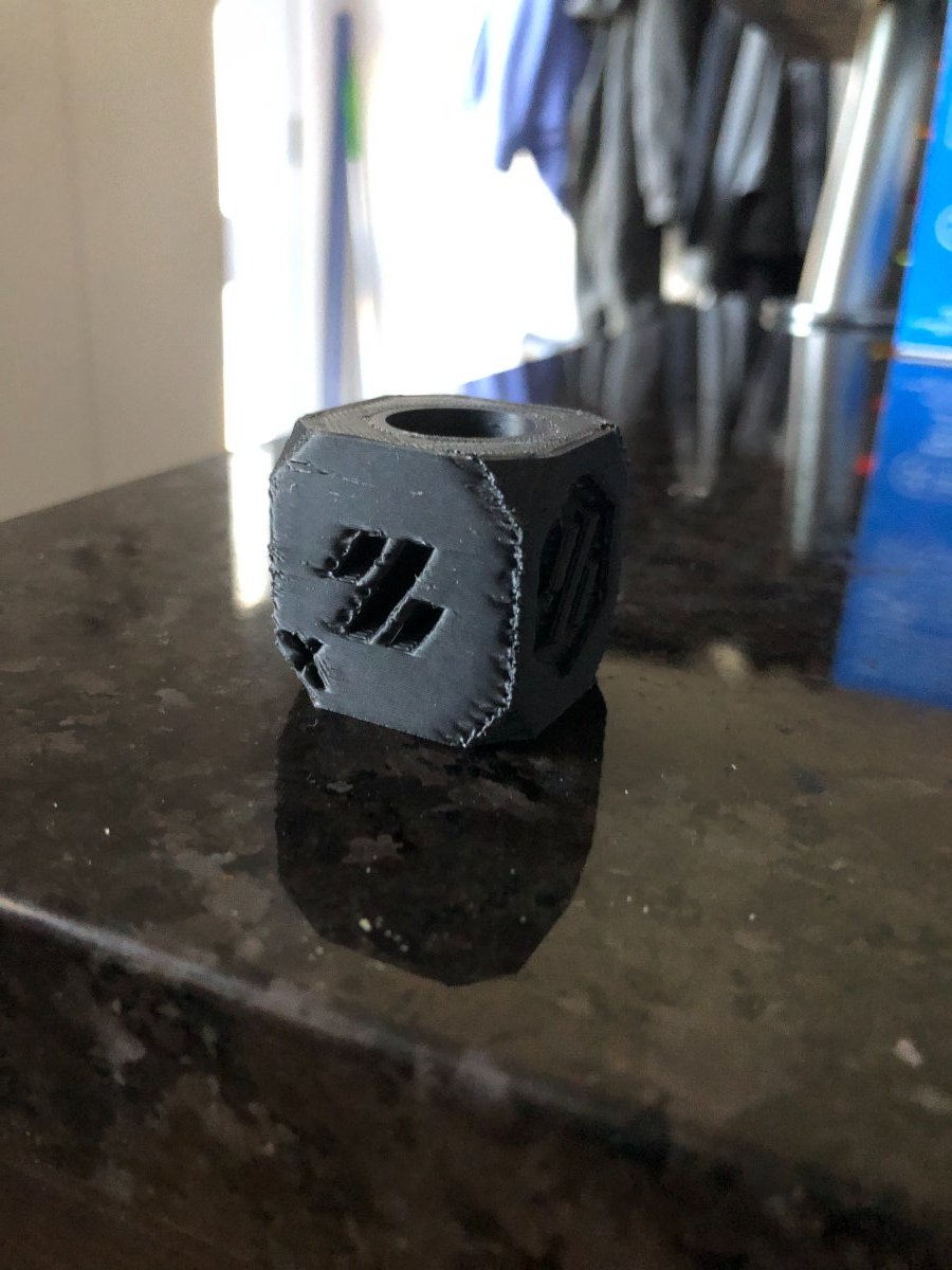

I've never had this issue before so I've changed something in Orca slicer unknowingly. It is like this on all four sides. Ran fine at PA 0.05 before. Any suggestion would be great.

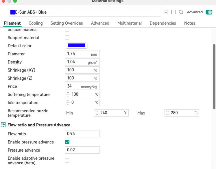

May still be. Have you tried toggle pressure advance in the filament section and see if it makes a difference? Or did you perhaps enable the Adaptive pressure advance?

I don't know your setup, but a PA of 0.05 seems quite a lot to me. On my setup I would expext the prints to look like that with that high of PA value.
What nozzle size, filament type and extruder setup are you running?
For me with most filaments and 0.6mm nozzle size, goliath short hotend it usually ranges from 0.018 - 0.039 at most.
0.4mm nozzle size needs a little higher PA values, but nothing near 0.05.

Thank you, everyone, for the reply. It turns out the pressure advance in the filament section in Orca got unchecked. The 0.05 was what I was seeing in the Klipper Extruder IU section, which is the default from the Klipper setup.  All prints are back to normal.
