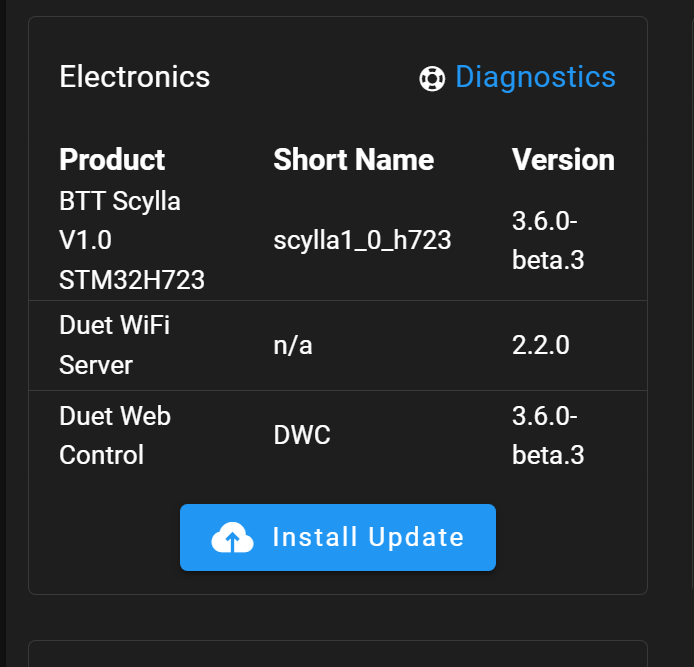

Yes it should. I'm not sure why that not updating properly. For now, until we have your router setup properly let go back the V3.5.4.
Edited by PFarm
If i have updated the rep rap firmware to 3.6 do i not need to update the web control ?
4 minutes ago, Stevo said:

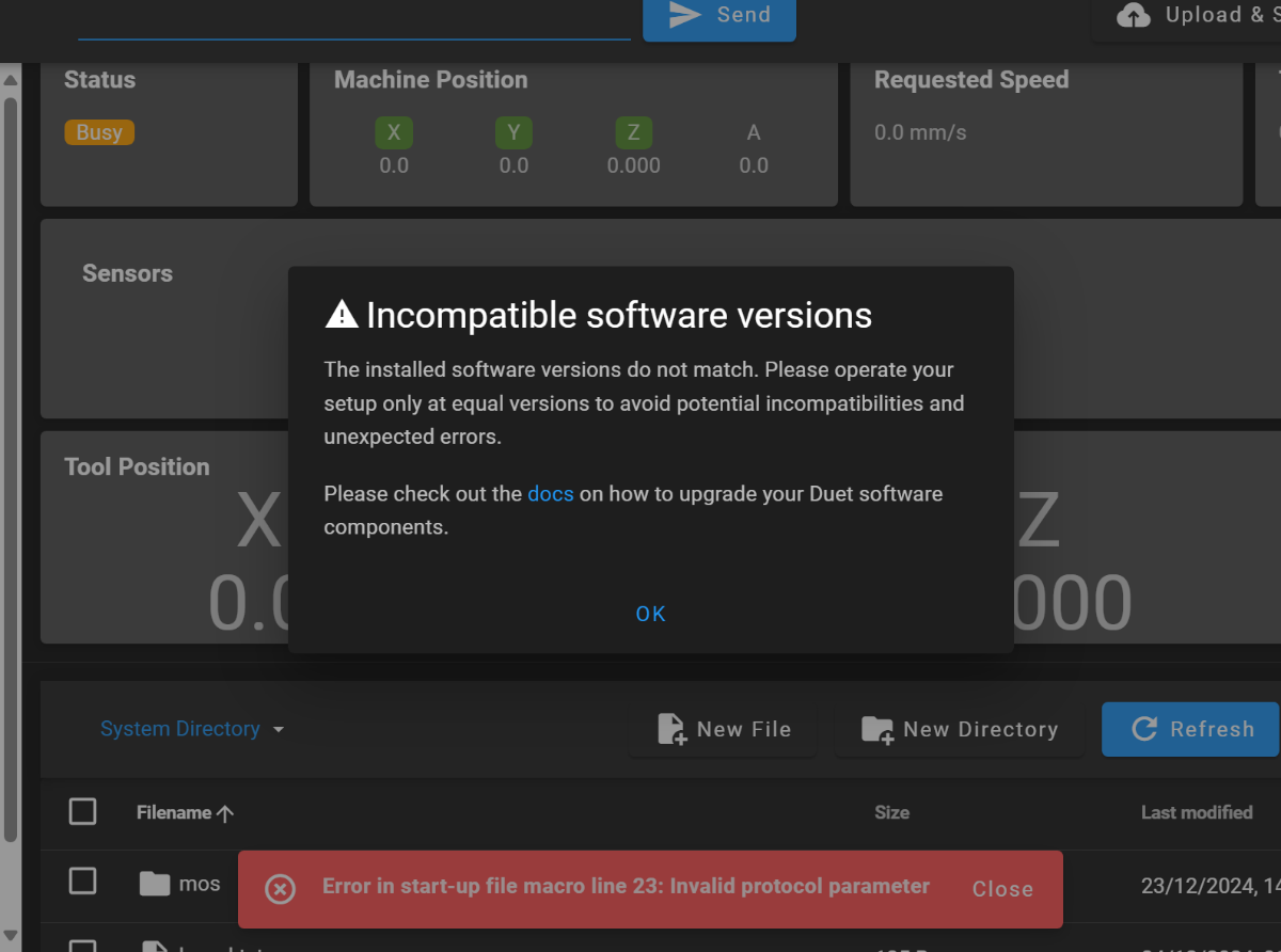

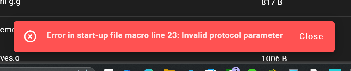

So started a fresh i have both now at 3.6 however i have this error any ideas please

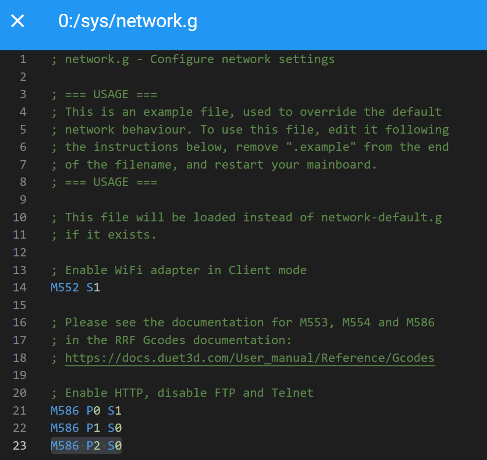

Nicely done! You get rid of that error by deleting line 23 in the network.g file.
3 minutes ago, Stevo said:
Thanks

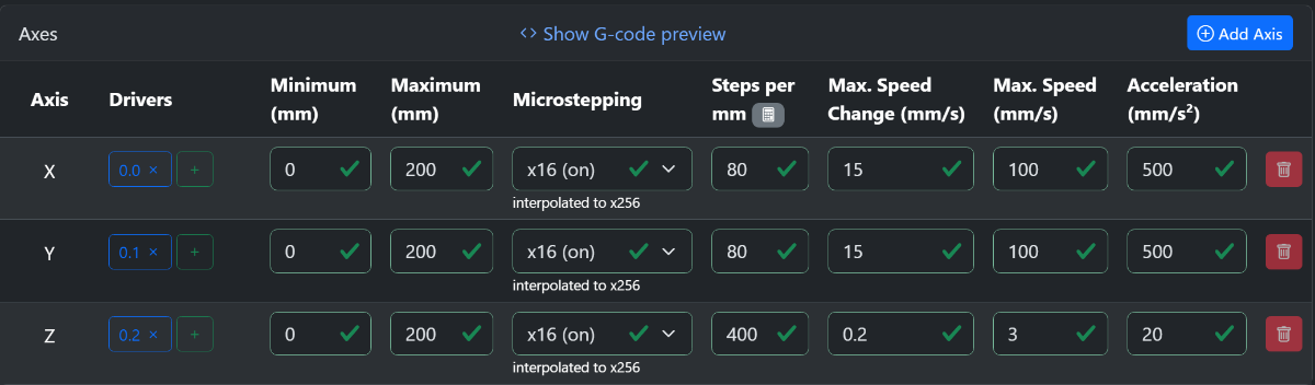

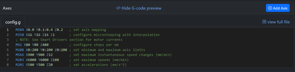

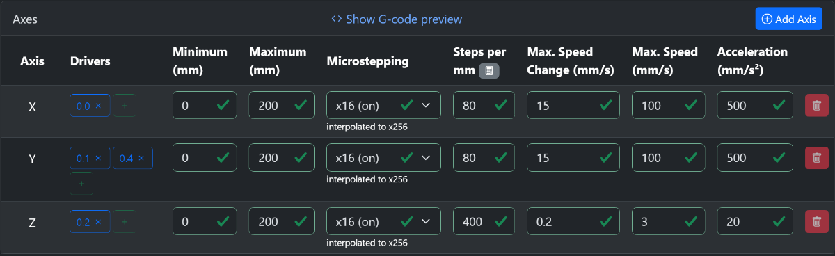

Sorry i spotted you asked me something earlier and i hadnt replied i used the rep rap config tool just messing about really and noticed if you clicked the plus sign next to the drive it would add a drive to an existing one then clicked on the view gcode tab to see what it had changed.
1 minute ago, PFarm said:
@Stevo Thanks now you've taught me something.
