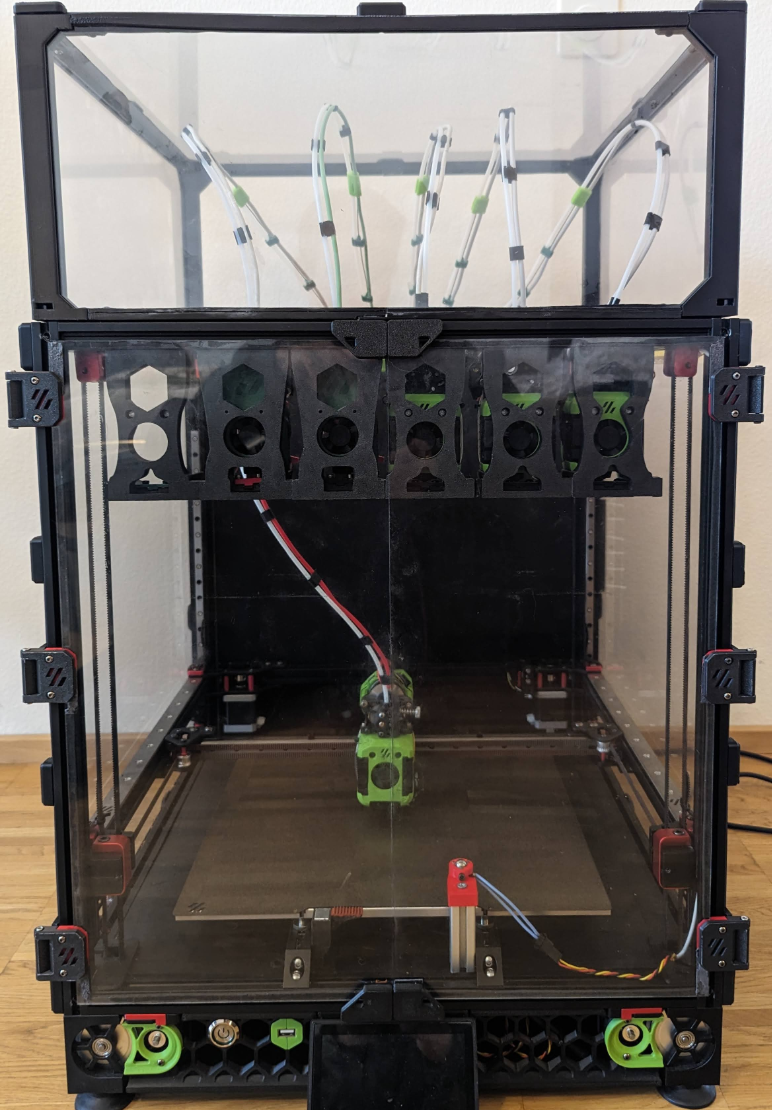

So I have decoded I am going to bite the bullet and do a bit change to my printer as getting sick of changing fillaments and want to be able to do different colours in some prints as well and think I am going to do the tap changer mod going to set it up to handler the full 6 print heads bit not going to put them all in straight away going to go with the rapid burner head as this one can handle the rapido2 uhf that I am running and going to go with galleleo 2 as well but will be in the orbiter 2 print question for all you clever printers out there what ebb 36 board would u go with for canbus as I have to change my can board
This is going ro be a slow build as is going to be pricey but isn't that half the fun of coron printers

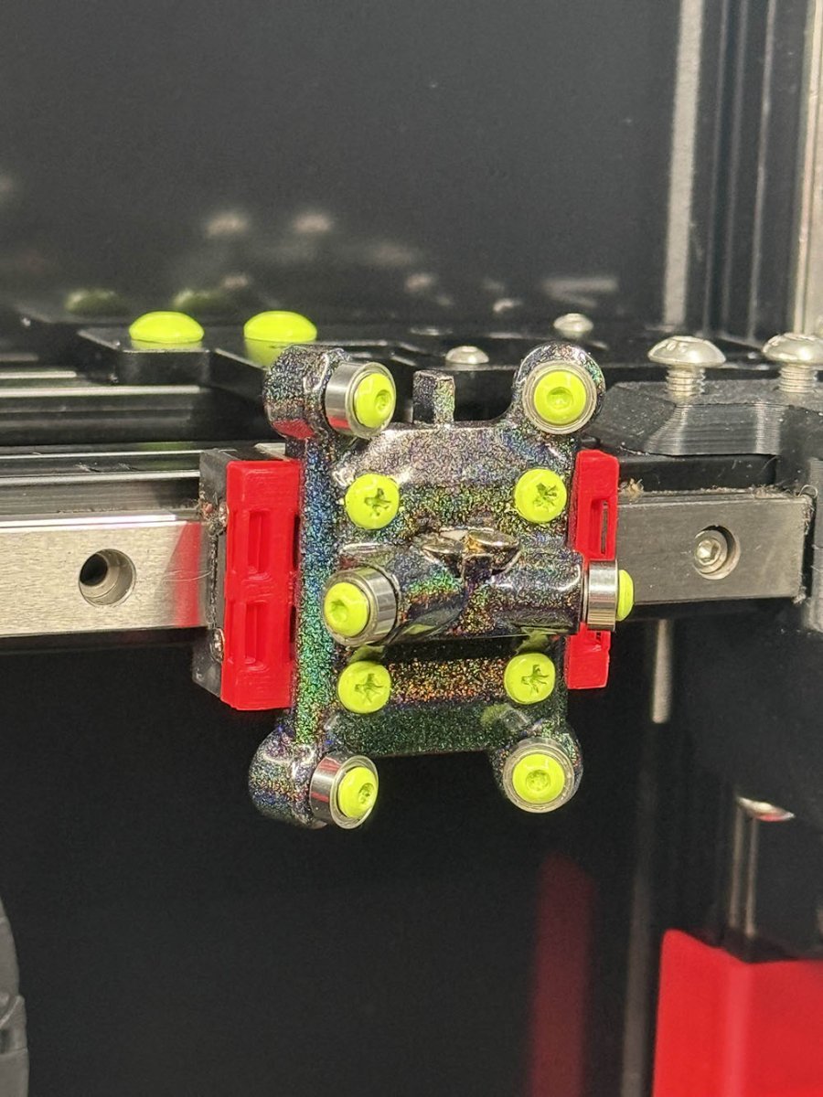

I recently printed the shuttle in SLM Aluminum via a service company. I then powder-coated it in holographic powder (I have been powder-coating for 6 years now).  I also think that Stealthchanger is a better shuttle and connection than Tap offers.

Stealthchanger uses rods, bushings, and magnets, while tapchanger uses just magnets. The bushings and rods give stealthchanger the advantage of preventing rotational movement of the tool head.

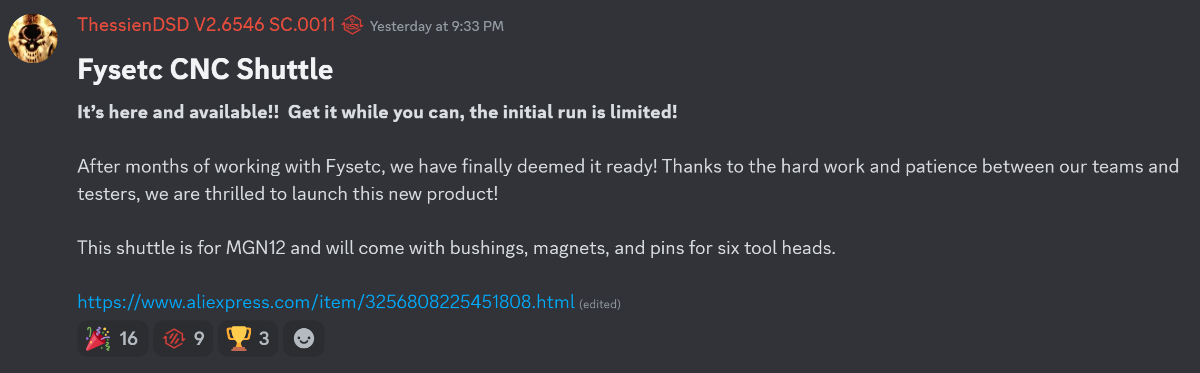

https://x.com/LDOMOTORSJASON/status/1873644031311544487
Here is what I have so far.  From what I have been told, some have been used in giveaways.  Soon is the word being used.

So last night I found something on ally express for the shuttle for stealthchanger looks like only the shuttle and looks similar to the ldo one will put a link up soon
