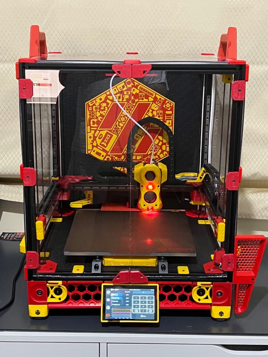

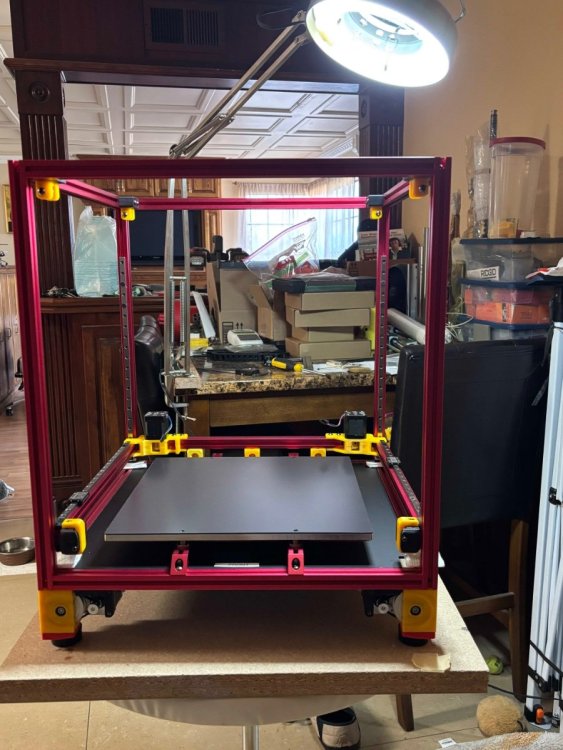

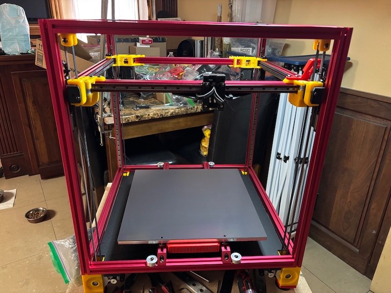

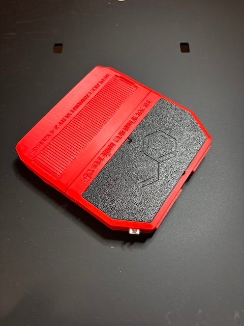

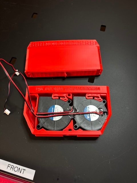

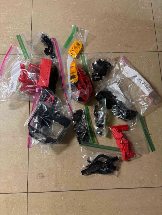

So I wanted a bigger 3D printer. SO I read about the Voron 2.4 build it your self printer. Looking at the well prepared Instruction manual, seems doable for me so I got the LDO 2.4 R2 RevD full kit. So far, other than a bad SLR12H linear bearing/rail everything seems pretty good so far. I have build it up to installing AB Idlers, now waiting for the replacement SLR12H. While waiting, I am printing all the parts needed for the build.

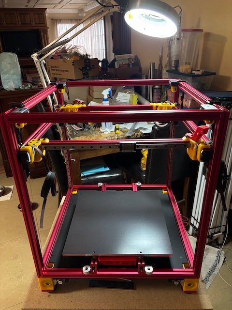

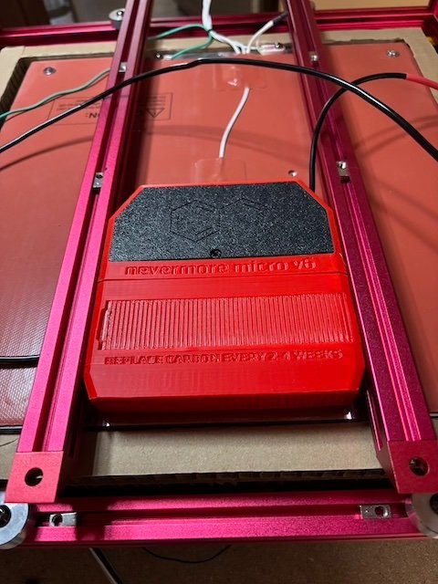

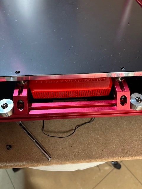

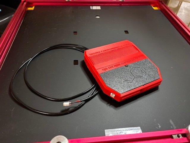

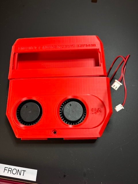

Got a little bit of progress in my Voron. Replacement part came in Thursday. I opted to build the Nevermore V6 and install it first so I don't have to mess with the bed later on. Got the gantry hanging and trying to figure out how to square it.

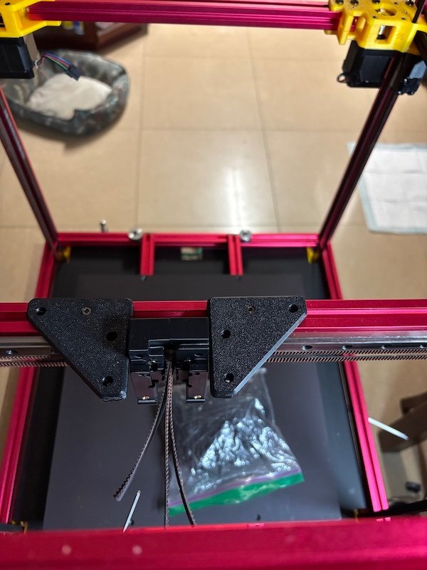

Thanks, I deleted them and uploaded converted jpegs. Wonder if you have any advice or trick that I can follow to make sure that my gantry is squared. I followed all the steps in the manual. Thanks
Build update.

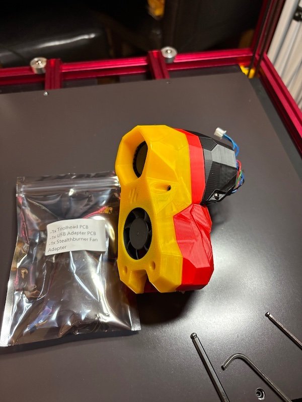

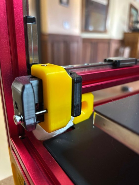

Installed the gantry and the installed the Z and AB belts. Fixed the gantry racking pre and post belting following "NERO's" video on solving gantry racking. 1 thing I found that helped me make tightening of the belt easier was to place a bracket on each side of the X-carriage (see picture) to stop it from moving while I was pulling on the belts. Putting together the stealthburner is next. I would like to ask for opinion about getting a Voron Tap vice installing the Klicky that came with the kit. Being novice about Voron particularly in software programming after this is built, which way do you advice I go. Thanks.

Clever idea on installing the belts - thinking outside the box!

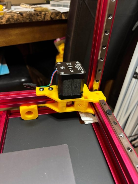

It really is addictive but no problem, I am already an addict in building and designing stuff ha ha. Replaced the original Voron X-Carriage with the Annex-Engineering X-Carriage for the Beacon. I didn't want to mess again with belt tensioning so I came up with frame belt holding bracket to keep the belts in place while I remove and replace the x-carriage. Someone might have already came up with this but this is what they look like (see pictures). One for each side of the carriage.
I like your innovation. A true "builder". Good progress. Funny how once you start, you just want to keep going
