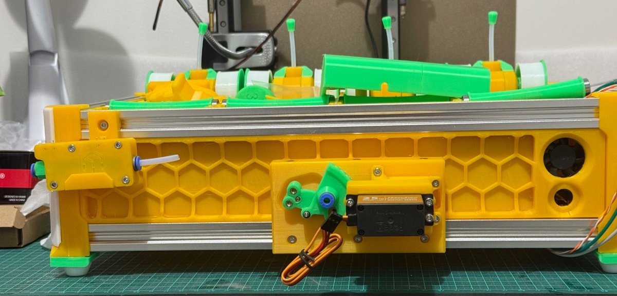

@PFarm - yes using a nozzle wiper, but one from Bambu Labs. I have this on my VZBot and now the V2.4 300mm build. All the other printers were swapped to silicone brushes.
Here is my setup:
I printed the parts from the Blobifier Repo plus a Blobifier Dropin adapter that I found for the Bambu labs brush, when assembling the blobifier . These are really cheap from Bambu labs themself. ($5 AUD for 3 brushes) Similar price for Canadian. $3.99 CAD (Bambu labs Nozzle Wiper)
Will upgraded the silicone brushes on the other printers over time, now that I have found the dropin adapter. Will be an easy replacement.

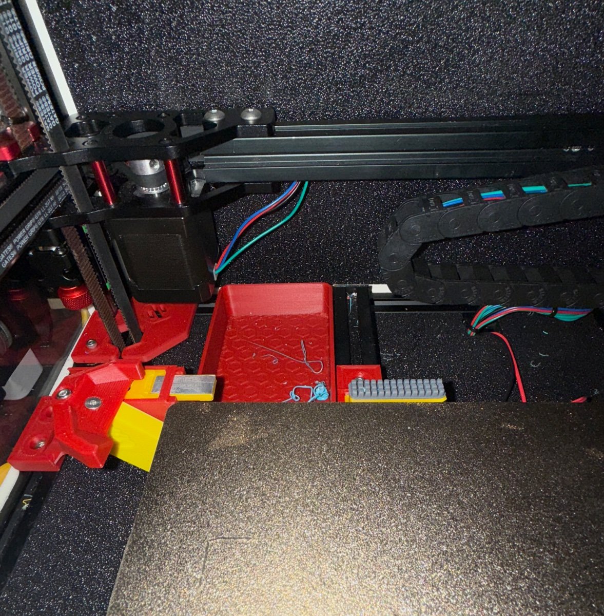

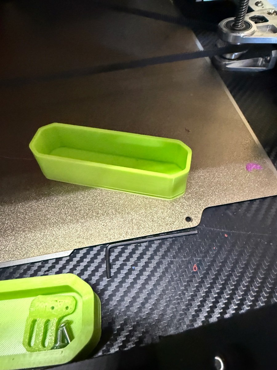

How have you mounted that on the VzBot?
I used this. Had to make a spacer to sit it level with the printbed.
IMG_1001.thumb.jpeg.e57ff1e15efc809c71580ac0bf94e194.jpeg        IMG_1003.thumb.jpeg.bc72655e5b1421c2fb500d7357c856fb.jpeg
Also made a bucket that press fits on the bottom. (Not as elegant as @Penatr8tor would have done, but it works)
Here are the spacer files as well as the fusion file.
Also use the "Blobifier dropin" mentioned earlier in this thread to mount the Bambulabs scrubber.
vz-330-poop-and-wipe-chute Collection Box v3 spacer 3mm.stl vz-330-poop-and-wipe-chute Collection Box v3 spacer 4mm.stl vz-330-poop-and-wipe-chute Collection Box v3 spacer 5mm.stl vz-330-poop-and-wipe-chute Collection Box v3 spacer 6mm.stl vz-330-poop-and-wipe-chute Collection Box v3 spacer.f3d vz-330-poop-and-wipe-chute Collection Box v4.step

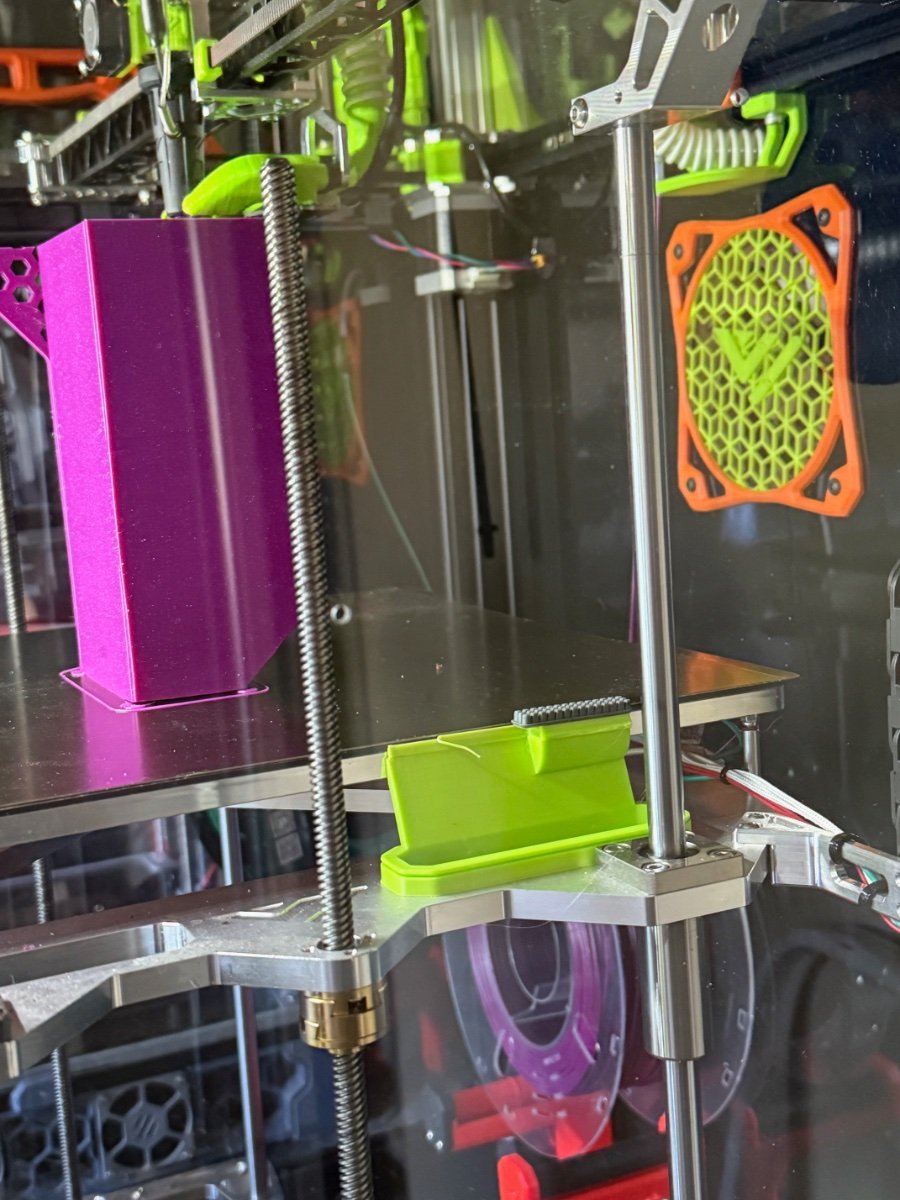

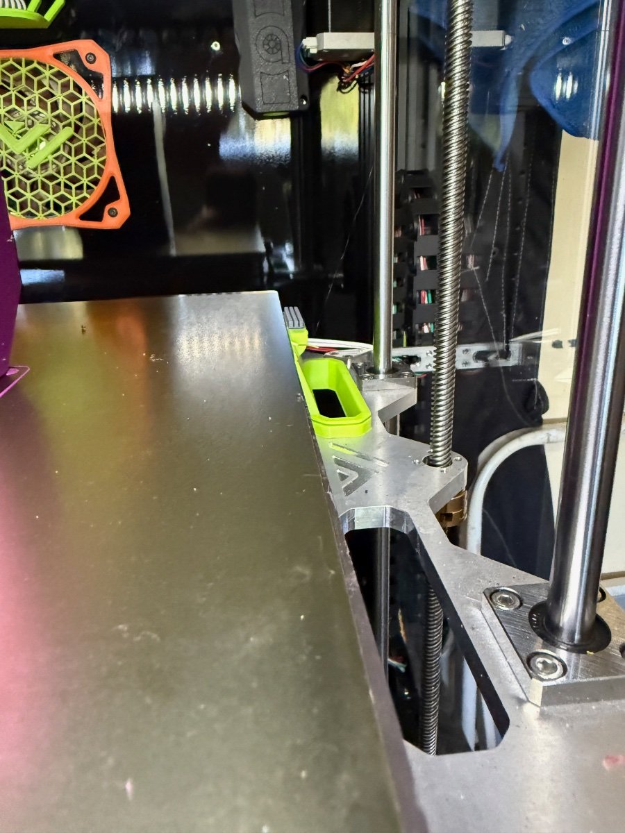

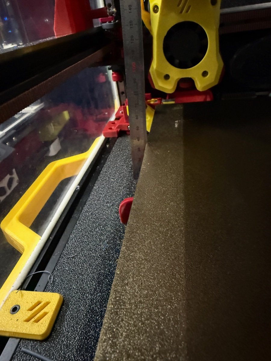

Mind if I ask how high your bed sits off the bottom?  I used the 4m knurled nuts to stand the aluminum bed plate off the frame but that makes my Y gantry lower bracket hit the shaker arm bracket.  It seems to be about 3-4 mm too tall.
My bed sits 40mm above the bottom panel. I had to adjust the back corner of the blobifier bucket for the blobifier as the rear right motor collided with the bucket.
i guess my plate and 300mm Voron is not typical because this didn't work out for me.  I have a bed of 35mm so my y rail attachment hits the shaker arm.  I thought to make it 5mm shorter but now it doesn't fit over the tray and servo arm for line up.  hmmmm  I guess i need to raise my bed by a few mm then.
Edited by therm_virtual0y
