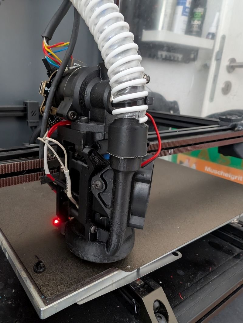

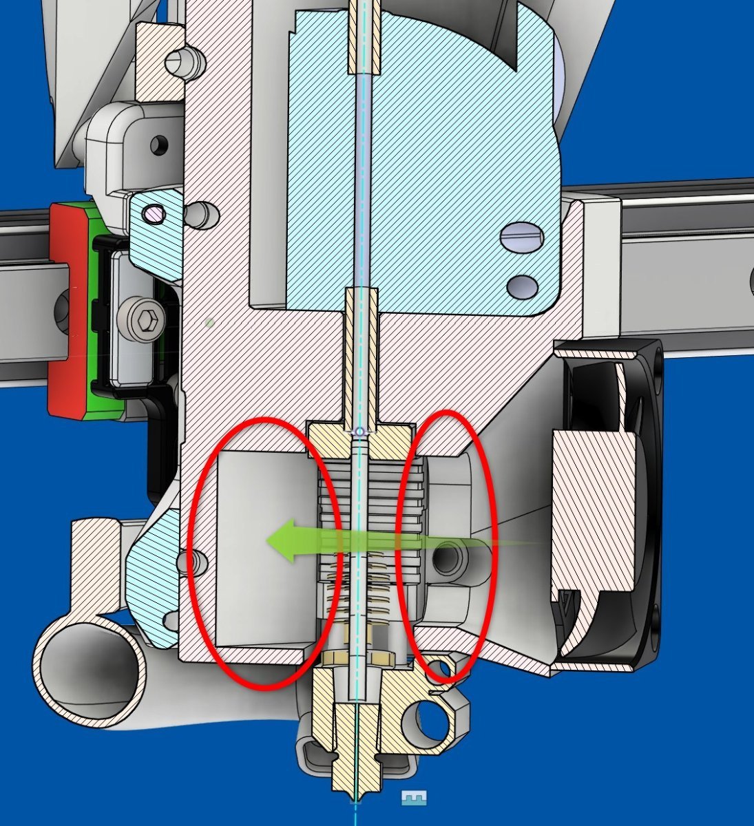

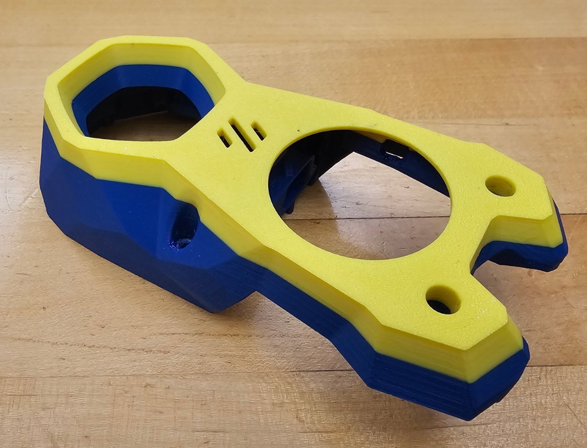

It's a good cooling solution, but it is very loud. Even turned down to 40% cooling it is loud.
I used this https://www.printables.com/model/620071-ultralight-stealthburner-cpap-main-body. It's a nice solution.
I think a bigger external fan would probably provide the same cooling but might not be as loud. I have a 120 mm fan from my vz330 kit RSCS that is doing nothing. I going to try and develop a duct for it.
  @TitusADuxass thanks for the info. That sounds, literally, like a good reason to look for another solution....
Last night I was counterplaying of utilizing the Crown Cooler with something little more Stealburner looking if I went with the CPAP blower..........
I may go back to Afterburner with the 5015 mod and make it work with the CNC TAP and the LEDs. Of course, I will have to get a BTT46 for the Bondtech LGX as CAN network is the way to go; I am not putting all these wires back in lol!!!!

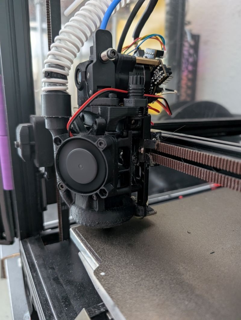

Here's my Stealthburner, Orbiter2 with Beacon_H implementation, maybe you can get something from it.
