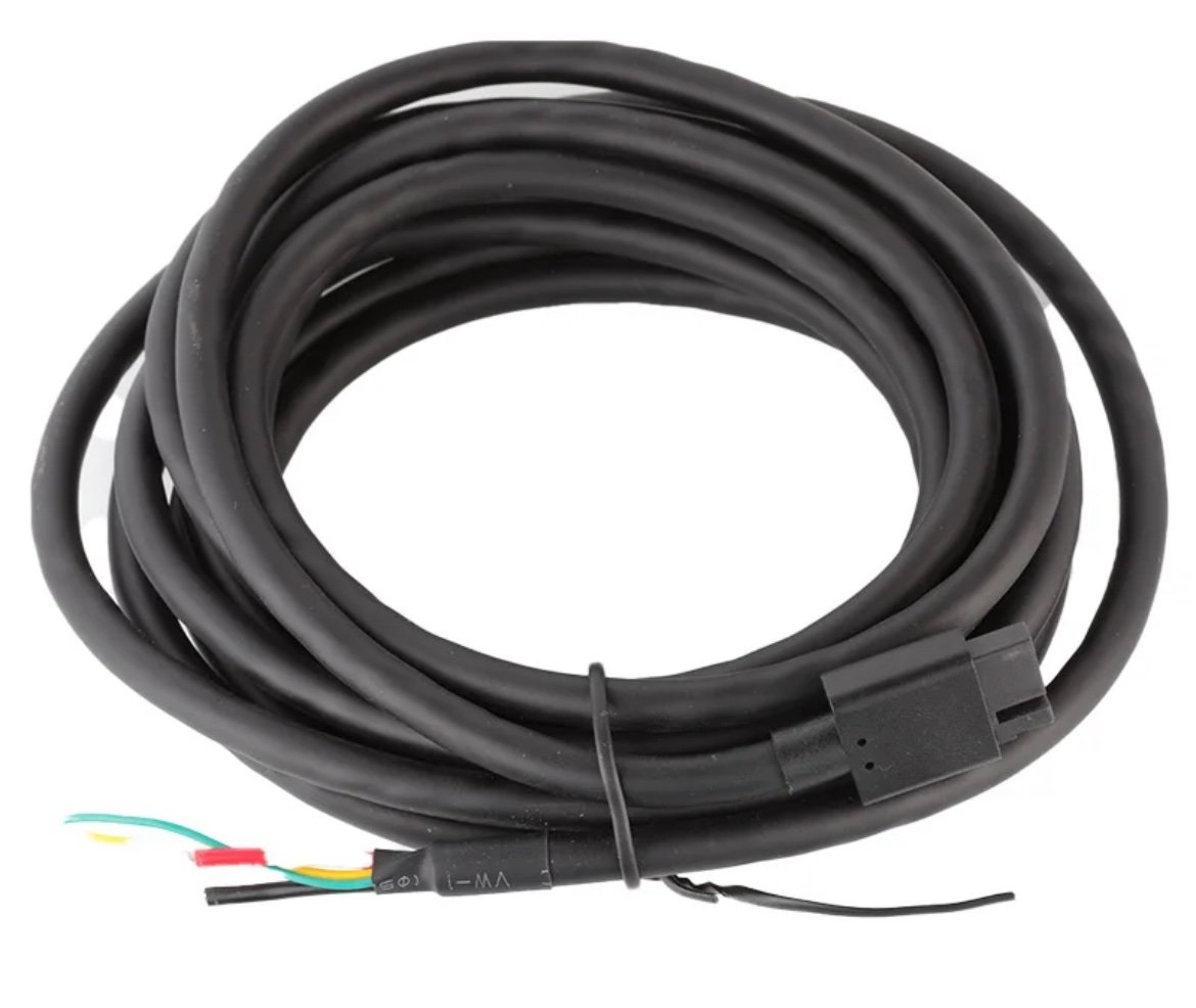

However I have found the sht36v2 and now the v3 as well to be more useful than the ebb36. Precrimped can cables, fan voltage selection, and lis2dw are small but decent improvements.

I recall one of the reasons I installed SB2209 first on my system, was because I only had 24v fans for the SB. And EBB36 did not support it. Meanwhile, my collection of fans has grown, and a 5v fan is also is common in my drawer. I also bought the Mellow SHT36v2 which came with a can cable. I like the one from BTT that came with the SB2209 better. and if I have need for one, will purchase from them (5 euros). Maybe not a bad idea anyway, for the drawer 😊

Mellow do pack a better cable nowadays with the v3 so that’s nice. IMG_9738.thumb.jpeg.11f0ee1163e01582f1522cdd5b6c9368.jpeg
