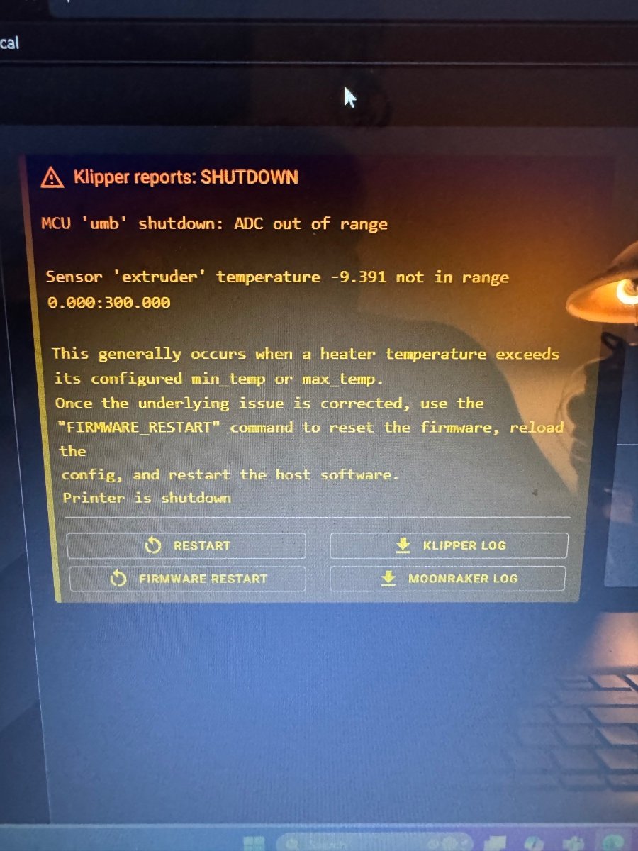

@Dirk I've started a new thread.
It's a v0.1/2 Manta M5P and EBB36 setup.
It was working but now I get the mcu is unable to connect.
The last klipper log entry is:
Extruder max_extrude_ratio=0.266081
mcu 'mcu': Starting CAN connect
Created a socket
mcu 'mcu': Unable to open CAN port: [Errno 19] No such device
webhooks client 281473280765616: New connection
webhooks client 281473280765616: Client info {'program': 'Moonraker', 'version': 'v0.8.0-331-gc857e1a'}
The hosts window gives me:
Host(aarch64, 64bit)
OS: BTT-CB1 2.3.4 Bullseye
Load: 0, Mem: 986.9 MB, Temp: 45°C
wlan0 (192.168.2.230) : Bandwidth: 2.4 kB/s , Received: 6.5 MB , Transmitted: 1.1 MB
That looks like the CB1 is working
The machine interface tells me that Klipper is dirty, KlipperScreen is dirty and Moonraker is corrupt.
I've tried repairing the 3 above but have met with no success.
I suspect that I will have to a complete reinstall of the board firmware, katapult and klipper. I am fairly sure that the EBB36 is okay, but I'll worry about that when I get the board sorted.
