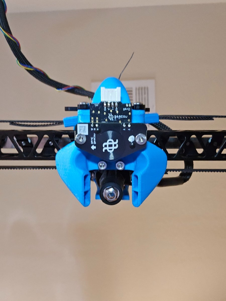

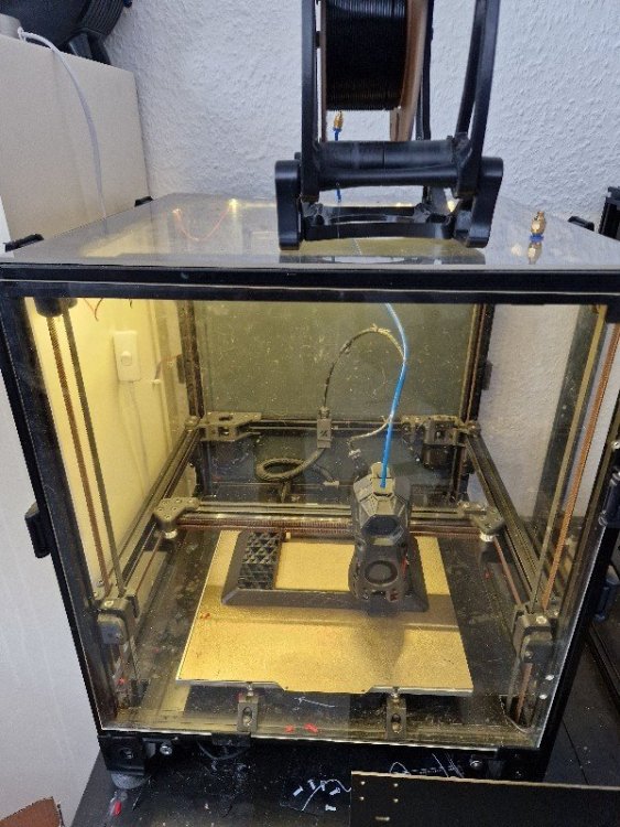

I assume the cartographer mount
Nice blue 🙂
Yes. Cartographers maker has been extremely smart by copying the form factor of Beacon D. I thought I saw the holes of the latest version were a bit wider. If I have seen wrong, then correct me please.

Nice blue 🙂
Yes... the blue looks good on the VzBoT
...and don't worry about being incorrect. We're all incorrect from time to time especially me. I'm an expert at being wrong. 🤪

I must admit that box looks great. 🥰
But not as great as your 2.4 with all metal cnc upgraded parts and 12 inch custom enclosed touch screen
And as I said, this is almost the same picture that @TitusADuxass showed. He is almost there!
And who says I am afraid of being wrong? Learning by erring is my standard mode of learning 😉

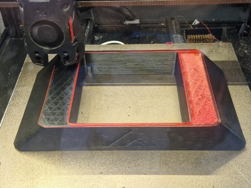

Started a print job for the exhaust filter fan housing and then realised that there's not a lot of ABS on that roll. It'll be touch and go. If it runs out, I'll finish it in red.

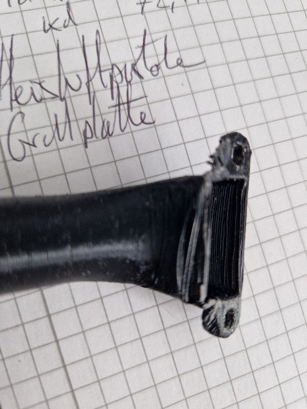

I also had another go at printing the upper duct for the print head. My v2.4 simply does not like this job, no matter how slow or what I do with the cooling fan speed it still comes out crepe.

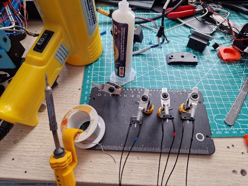

I did wiring up the three end stop switches. I didn't like the supplied wire, so I reused some of my v2.4 wiring loom that got deleted when I went CANBus.
Now this job did take me back in time, in 1979 I was taught how to so(L)der at the RAF School of Technical Training. I haven't forgotten how to do it, my hands aren't as steady as they were back then. The Antex soldering iron was bought at about the same time so that we could hone our skills in the evening. We had to sit a test - we all passed apart from Hutch who managed to solder the insulation together when joining two wires - a first for most of the instructors.
It also reminded me to find small heat gun, mine is a bit of an overkill for small jobs.

As for your failed CPAP snorkel... Use a brim. I hate using them but there are times... if you know what I mean. Also, it's a pretty weak part as well. It has some pretty thin walls. I painted mine with some acetone to strengthen it up a bit and to prevent cracking.

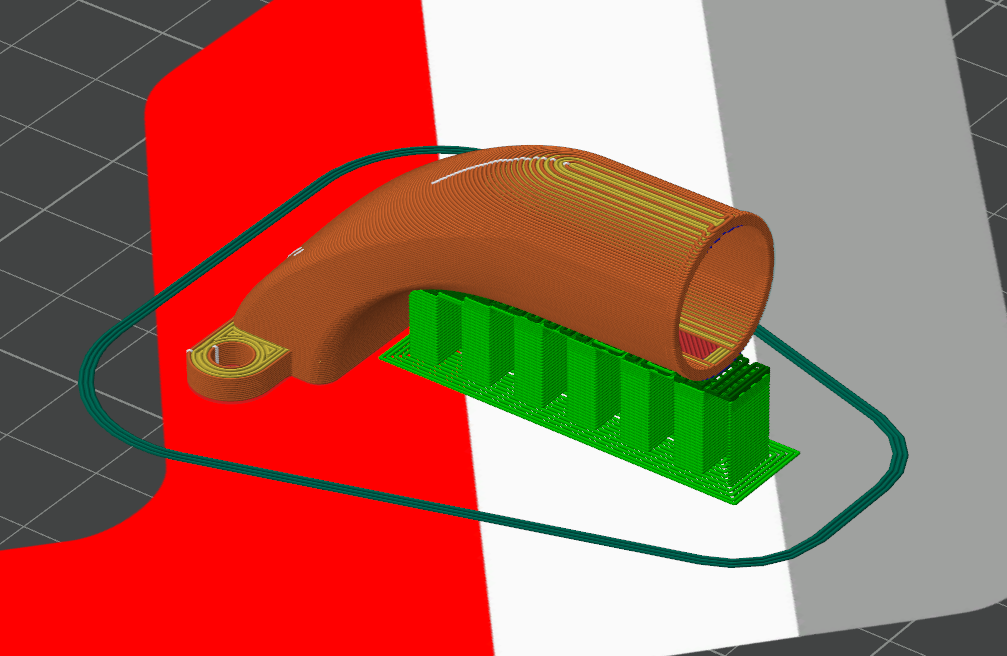

Re the snorkel, I must be printing it in the incorrect orientation - Orca always stands it on the end.

I don't remember how I oriented the snorkel, but I loaded it into Orca and oriented it like in the image below. I'm using manual supports and I painted a stripe along the bottom of the tube. I also use traditional supports because they are better for this kind of part.
I'm just trying that orientation, once I work out how to paint supports I'll be GTG.

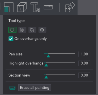

Easy-peasy. 😉
Select your model, then select this tool:
I prefer to turn on the overhangs only as shown, and mostly use the circle brush. If you highlight overhangs, that acts as a mask so you can be sloppy with your brushing.

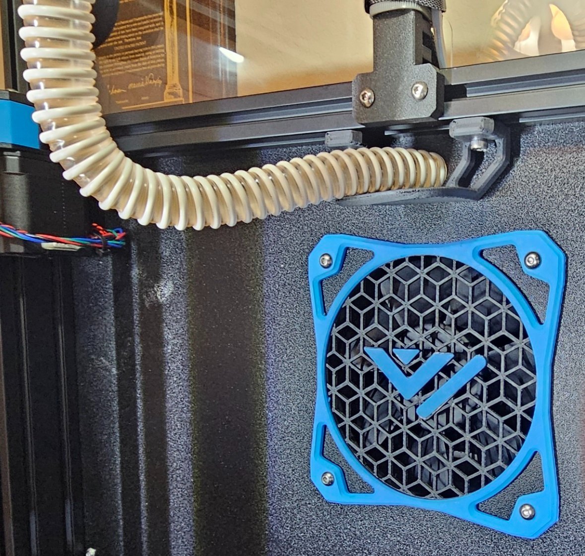

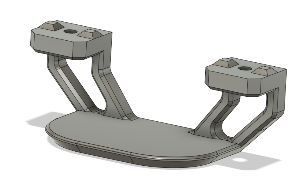

@TitusADuxass While you're printing parts... This is a good one to print.
I designed this shelf that supports the CPAP tube. Mine was drooping below the bed surface on prints with a low Z height and it ended working really well. It screws in without modification with a couple screws and hammerhead T nuts. The one I have installed was printed from CF PLA and is beginning to show signs of creep so I'm printing a new one. Maintenance!

Got it thanks.
Thanks, that's on the print list.
