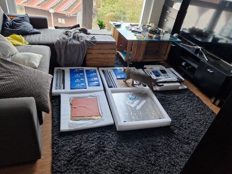

So it took a good couple of hours, but everything has been delivered and apart from some items being in different boxes.
Being a cynical barsteward it takes a lot to impress me, but this kit has impressed.
From the quaity of the packing to the quality of the compnents.

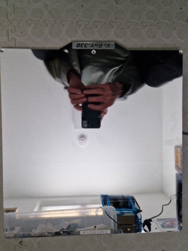

Look at the build plate, it's like a mirror! I first thought it was cold pressed with a protective sheet of something on it, but after further inspections you can just see machining marks on the surface. They must used a very fine surfacing cutter.
The gantry has the CF tube, all motors and rails are LDO items.
Crimping on the supplied wiring is beyond question.
When I compare this to the v0.1 kit that I got from fystec - you get what you pay for.
