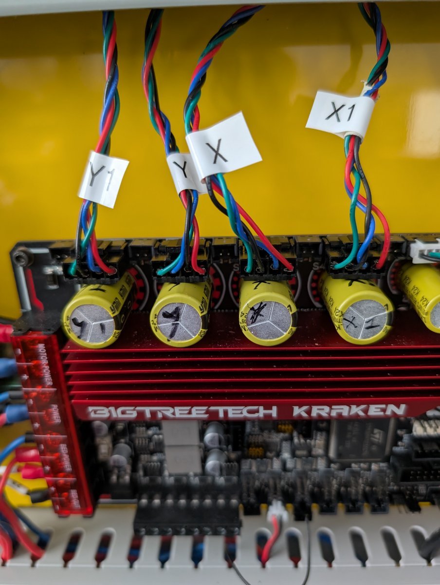

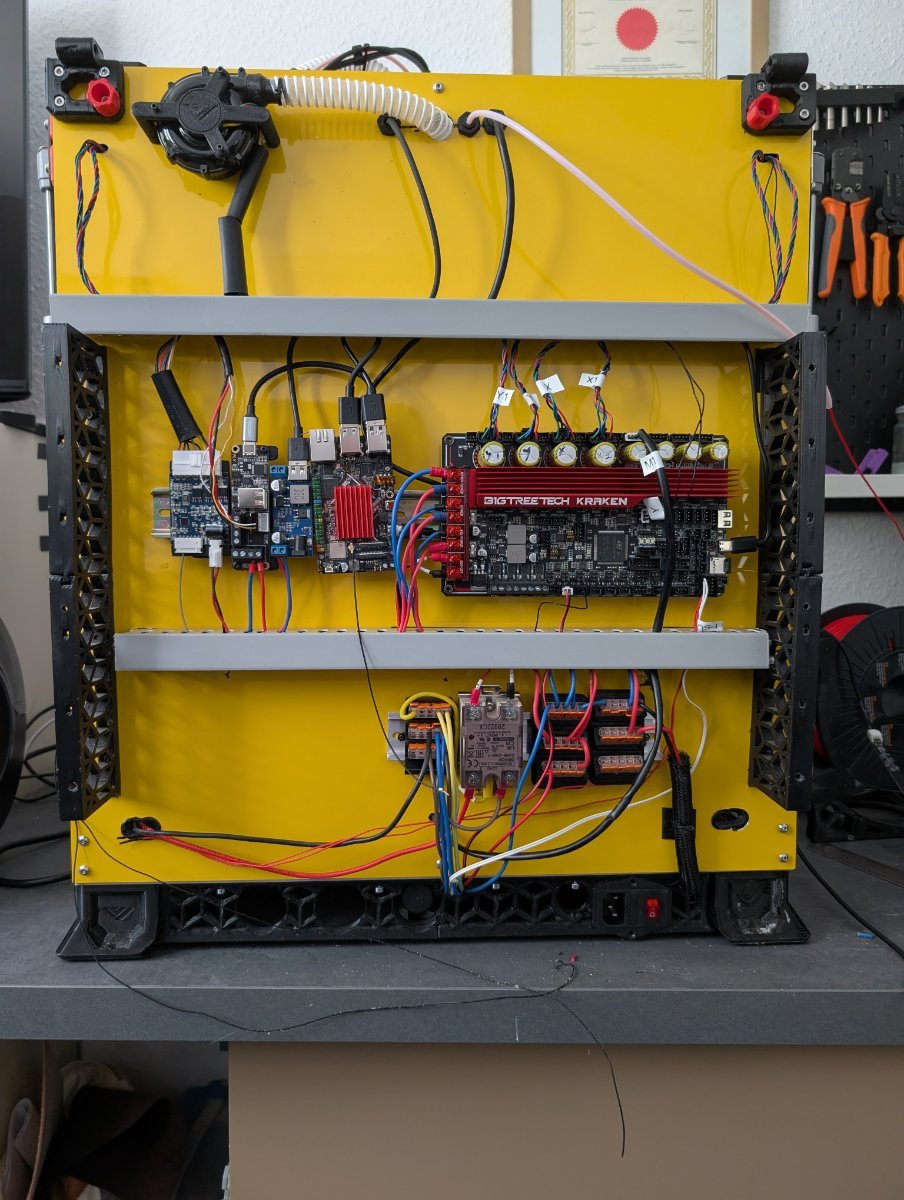

An interesting problem.
When I buzz stepper Y it does this.
All other steppers do the normal smooth back and forth motion.
So far I've:
Checked the 5160 driver power supplies
Swapped out the 5160 (both parts and ribbon cable).
Swapped the mainboard
Swapped the motor
and still have yet to clear the problem.
I connected up a spare stepper motor (TronXY 23) and that does someting different. It only moves in one direction.
The .cfg has not been changed from a known working config.
The only thing that I haven't changed is the Pi, but I can't see how that can be the problem.
Any suggestions good people?

Yes I had the other motor on the table. The other motor incremented in one direction, i.e. it went forward by 1 mm but did not travel back 1 mm. Buzzing Y1 gives a normal result - forward and back by 1mm with the appropriate sound.
I too thought about sync problems, it sounds very much like the motor is fighting against another motor. So I loosened off the grub screws on Y to allow it to rotate without driving the belts. It still does the same noisy ´movement.
Did you try a new good stepper motor cable when you tested?
I assume you did but at this point it looks like you've swapped out everything except the printer frame.
At this point you might want to try reflashing your controller. Crazy but hey... try everything right?
