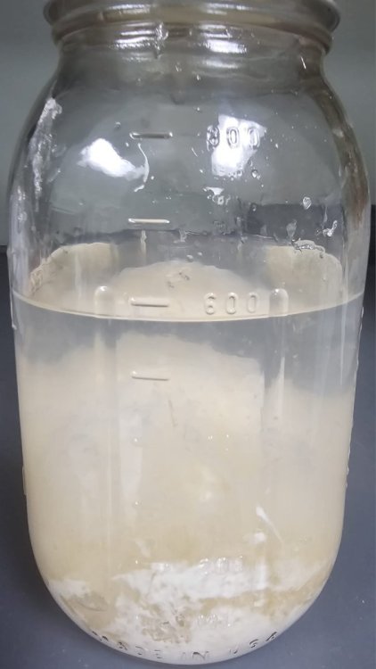

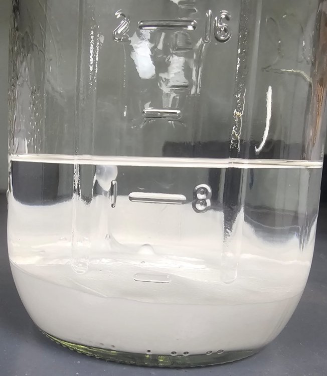

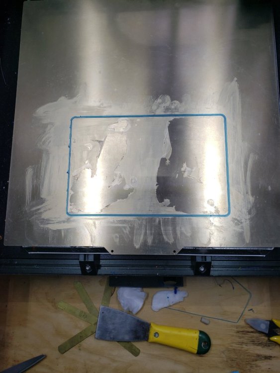

Update on my situation, I just  throw in the towel.
After trying so many combinations of PVA + water, I decided for a more agressive combination of 50/50 of pva, and then my glass bed exploded while I was trying to take out the print 0.o, I am sure there is a nice and perfect combination of a stuck + release agent.
I never tried the hair spray thou,
The best combination for me was defitenily the Elmer glue, that thing is just amazing, and I put more glue and IPA time to time.
However now without a bed, I just decided for a wham bam bed, just got my hands on one, will do everything by the book and wait for 72 to the glue of the bed to cure, and then I will relate back.
I am not changing sides, if I ever have a cheaper printer again, I will go for the glue option first hahahaha. I hope I will like the wham bam system as much as everyone comments on.
