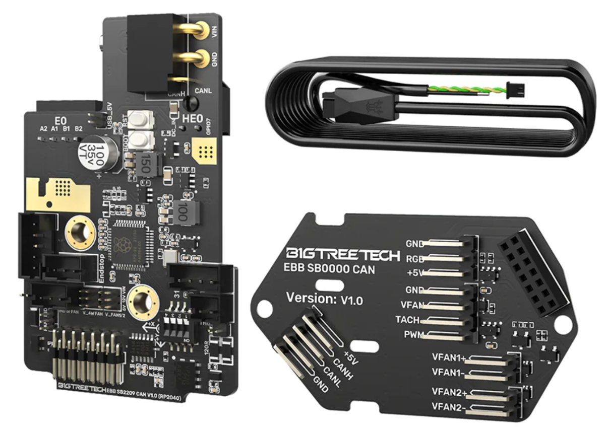

The BTT EBB SB2209 SB2040 is a nice CAN toolhead board. I bought one (21 euros with new years sales), and after that bought a second as a backup (23 euros sales during valentine). I am now looking if I should get a third one 🙂
I did print and use a mod for the SB CW2, so the 120R pins and the Thermistor pins are not damaged and the thermistor cable can run freely.

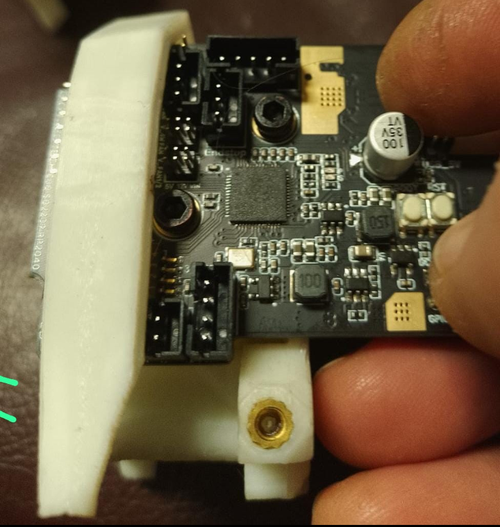

have a link to take a look?
I dont think its an issue with the 2209 2040 board, but want to be sure...

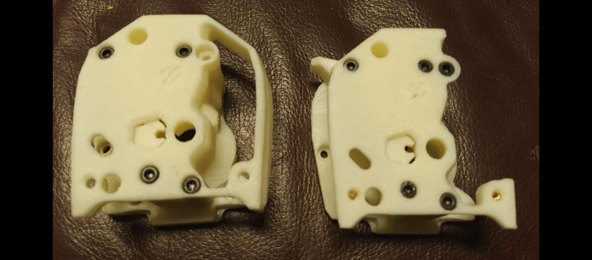

There is no link. I am the only one complaining. BTT Helpdesk thought I printed and mounted things wrong.
You can check the btt github for ebb.
But here are some pictures I made.
Left original cw-2 plate, right the mod from printables.
Me showing how the pcb lies on the cw-2.

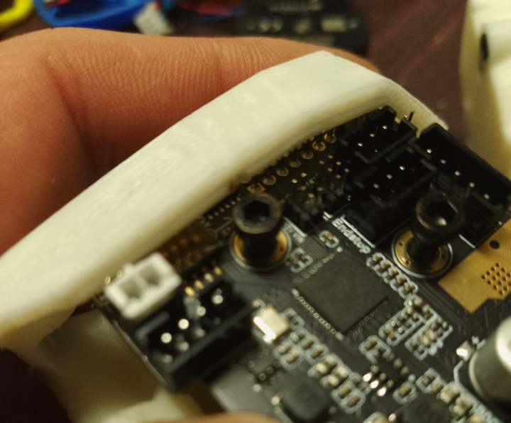

How with a thermistor pin it rides into the edge. (Which damaged my thermistor and my jumper below it on the 120 ohm resistor
Here on the modded one, free willy. No damage. All freedom for cables and pins.
Here BTT or CL person showing me I am stupid and can't mount pcb properly
