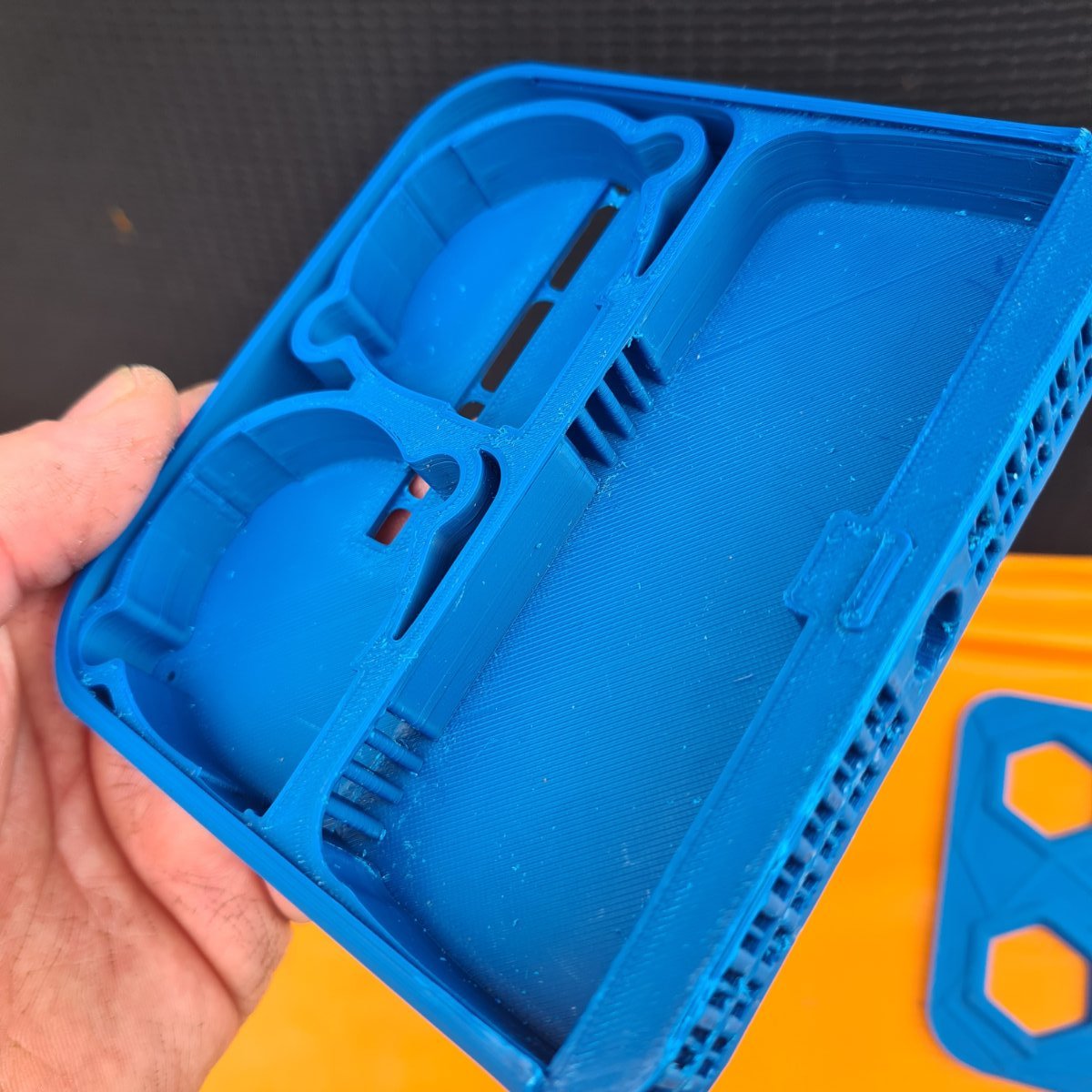

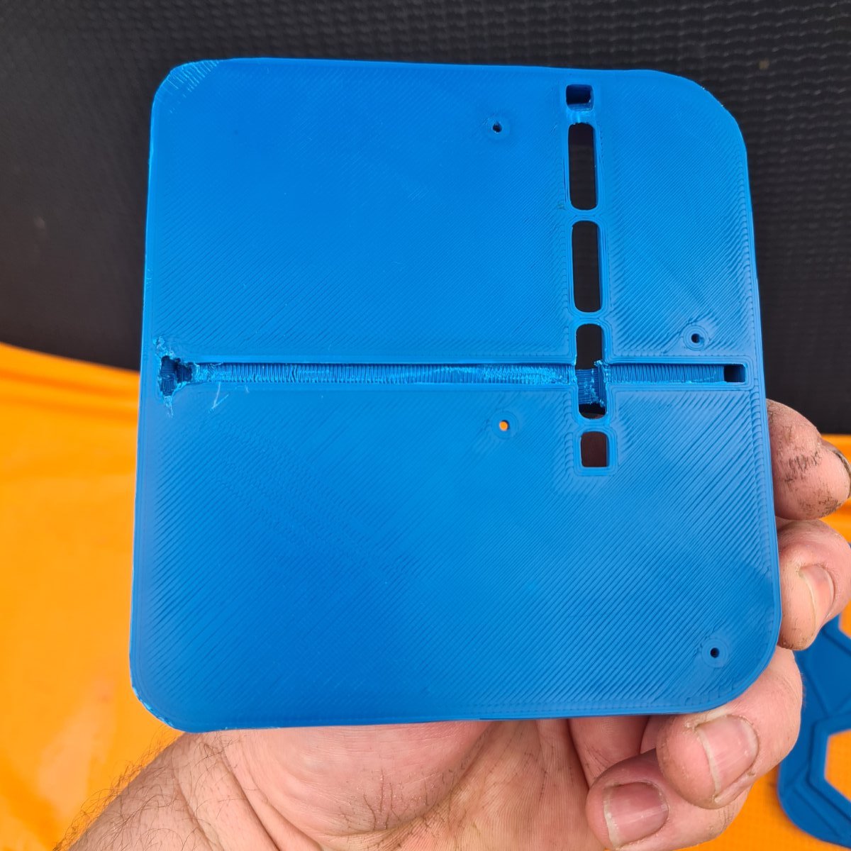

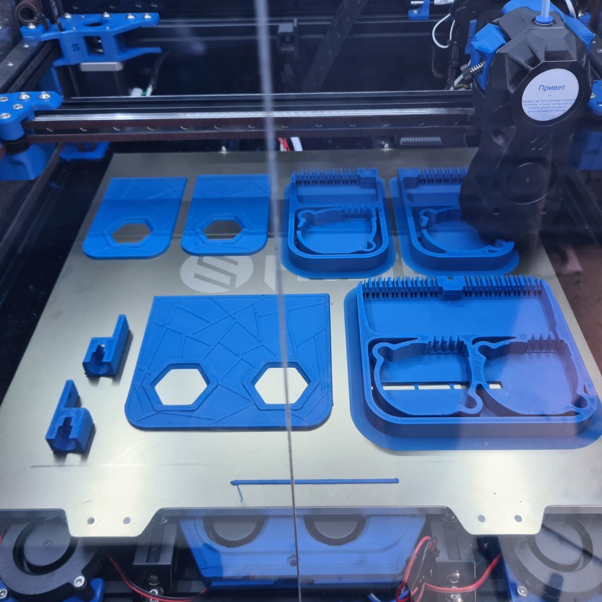

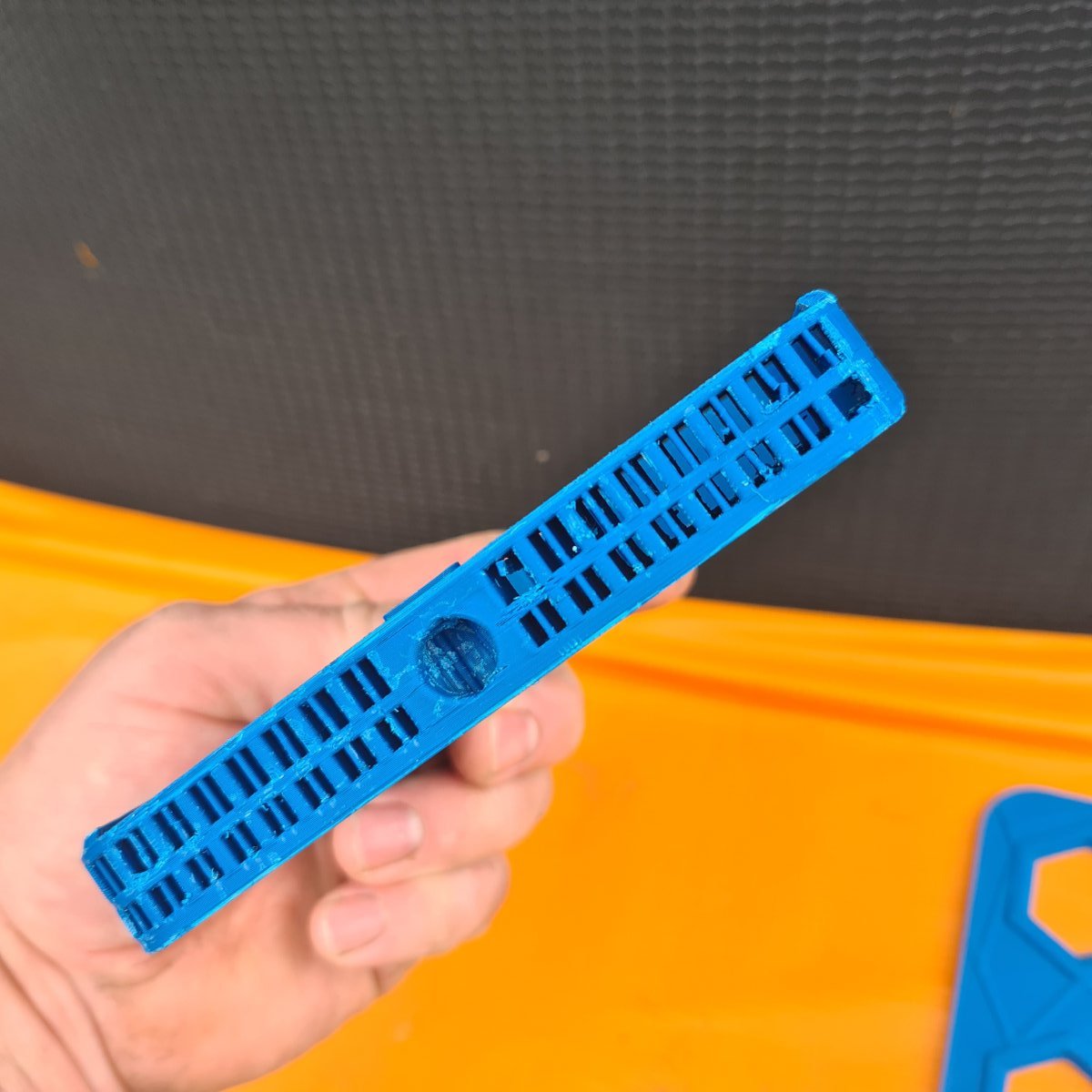

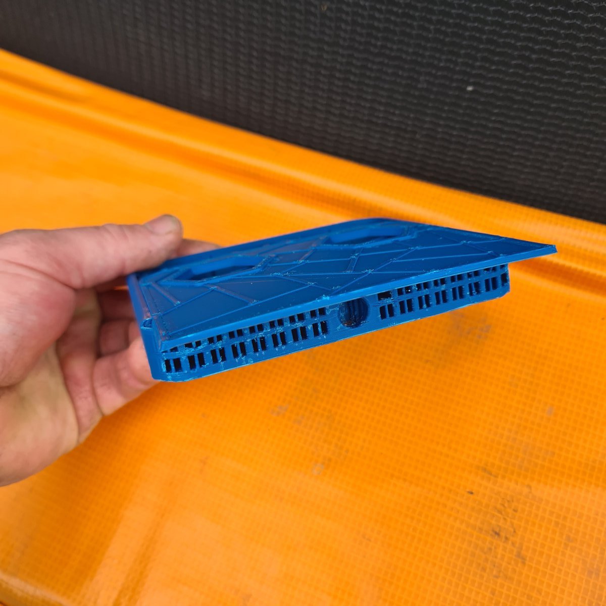

So printing my under bed filters went away from the v6 and went to a different setup from printables and must say is a much easier print to knock out than the v6 same fans just needs a pogo connector I am doing the 2 side fans to on my build so total of 4 fans not sure if I will fill the outside ones with the media but middle one I will curious on everyone's thoughts I also found a better mount for the umbilical cord and is simple will try and sit down tonight and mod the drawings I got from @Penatr8tor then will send the modded drawings back for any one who gets the same camera and wants to use them
Edited by sleepster217
Here is the prints hopefully dont run out of fillament I think there will be enough fingers crossed I did one the other night with infill this time no infill the infill one was a pain getting it out of the air vents and ended up damaging the print just waiting for the pogo connectors of ally express to come then I can hook them up but they are looking good looks like u can change colours on the lids but I have no idea how to do that yet

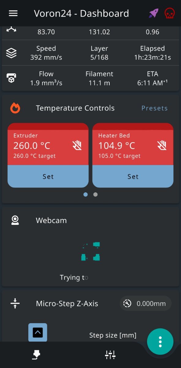

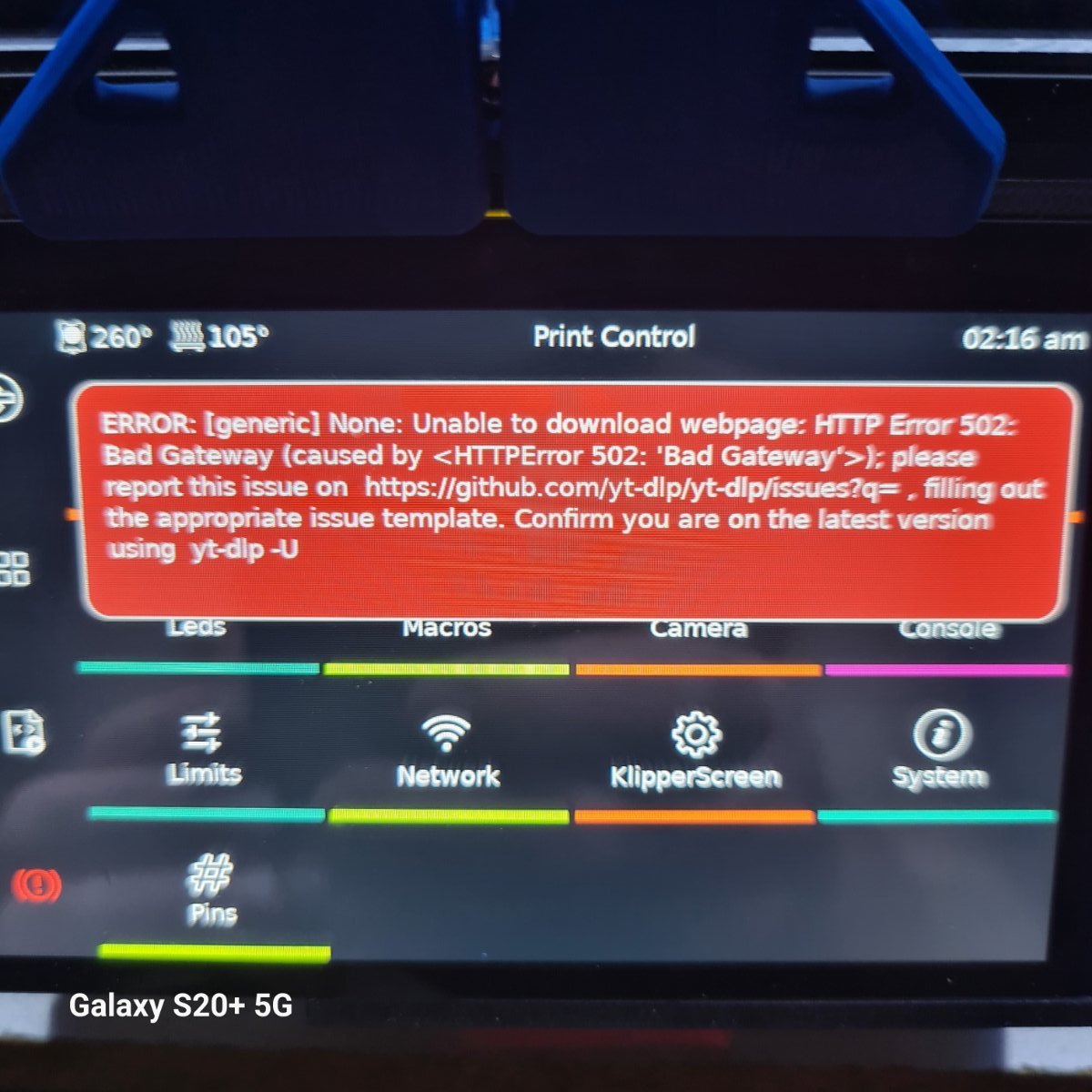

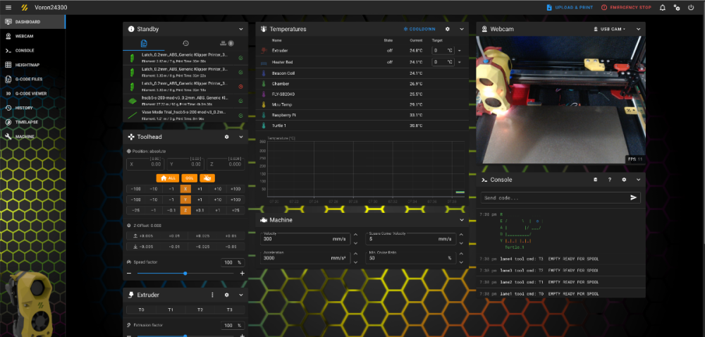

Hi so finally installed my camera as I had to do a couple of small mods to the stl so the version I have fits I have gone into orca and profile set camera with the ip and the Web site but when I go into orca camera is not showing a f when on my phone is not loading see pic
I am assuming is something not set right on the Pi?

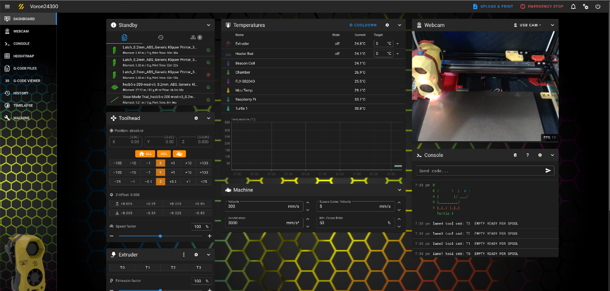

BIt confused - In Orca (slicer) the camera should show up in the Device Tab, if correctly configured.
On your computer, mainsail/Fluid is the interface and the camera is set up by adding it under settings, the enabling the camera view and it should show up.
On you mobile phone, on your local network it should be mainsail that is displayed with the camera feed, OR  Mobileraker as the interface if installed on the Raspi and your phone.

So u have a bit of an idea what i did got a adua cam from core is a newer version and had to mod the case to hold it .pluged it in bolted down. went to settings entered my ip 192.***** and then left the url in the defaults on both lines.
When u scroll through the my printer in show what should be a streem but says error .
On the Octoeverywhere/
Mobileraker is shows a trying to load camera but just the funny icon will show a screen shot.
if I change the setting on stream type it it says not supported yet or be a supporter u only get one option and am on that just will not load up

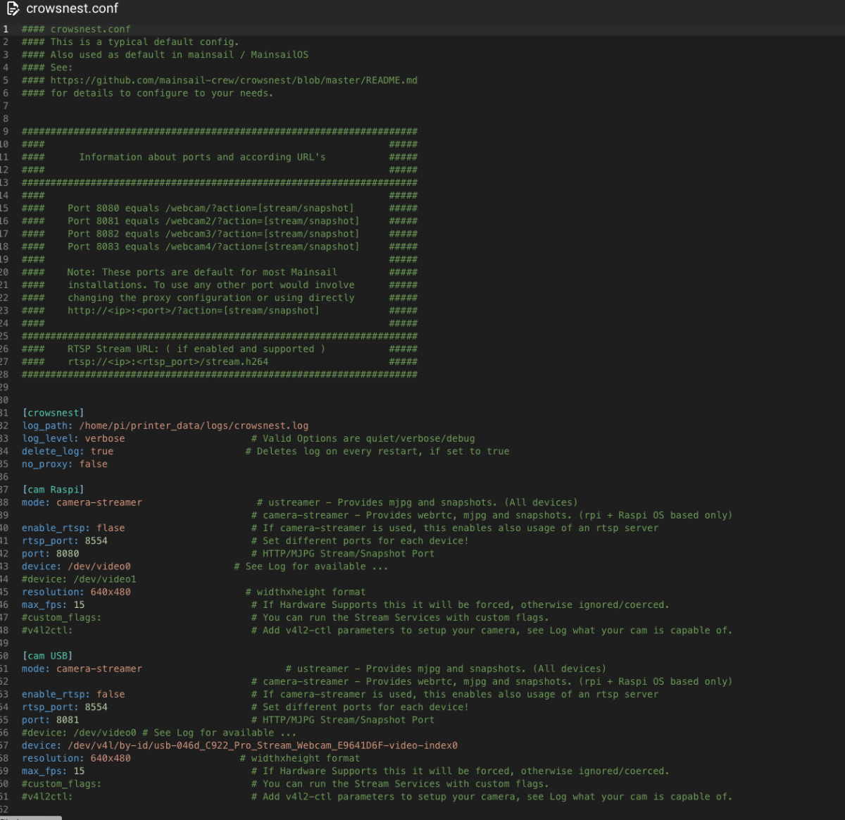

Open Mainsail and connect to the printer

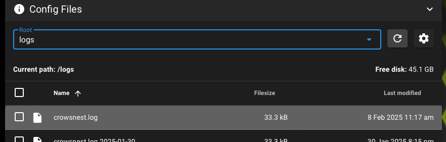

Check your crowsnest.conf file and ensure you have the correct camera settings.
If not then:

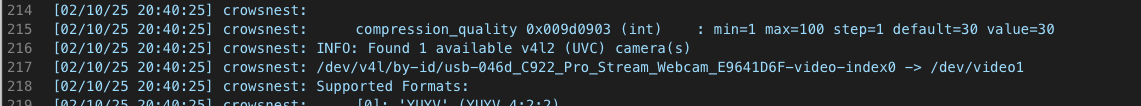

You can get these from the crows nest.log file
Enter this into the crowsnest.conf file

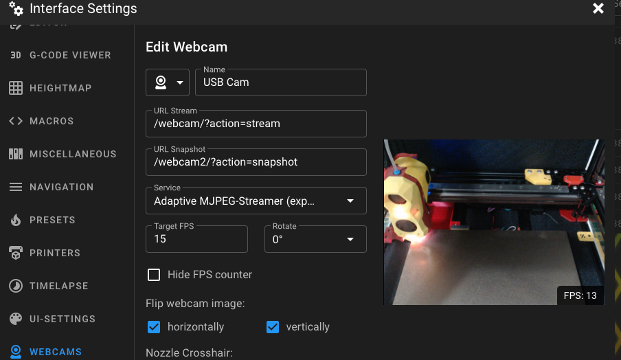

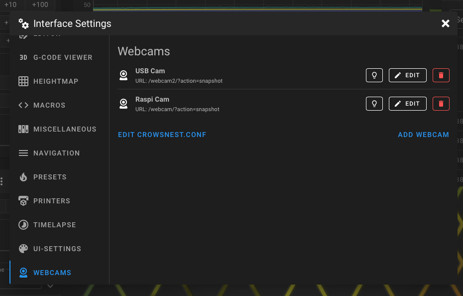

Go to the interface settings button in mainsail. (right upper corner)
Scroll down to webcam section, click add webcam
If configured correctly, your camera should show up, if the correct settings for your specific camera is added in:
Once you get it working here - it should work across all platforms (Mobileraker, Octoeverywhere, Obico, etc)

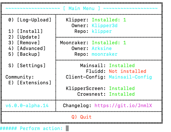

I don't have crows nest I will download it now
6 minutes ago, sleepster217 said:
Yeah have kiauh and just installed
So deleted my original settings after installing crows nest and now it is working I assume that while u are not on the printers network the fps are slow and that is normal
Yep it depends of the speed of the network you are on. If you are on 4G mobile network it will be slow. Also depends on the upload speed of your home network (Printer network). I have a high speed NBN connection (950Mbps download and importantly 56MBps upload) The bottle neck when connecting remotely will be the upload speed.
