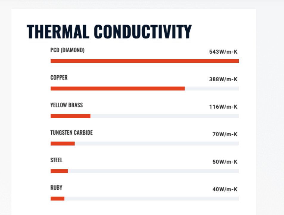

The Rapido 2 UHF is a good hotend. If you're using the black steel hardened nozzle you might need to print at 5-10 degrees hotter or not, depends on the filament you're using. The diamond tip of the Diamondbacks thermal conductivity is literally off the chart compared to brass with steel being less than both.
Yeah using the standard hard steel ones (black) v6 style

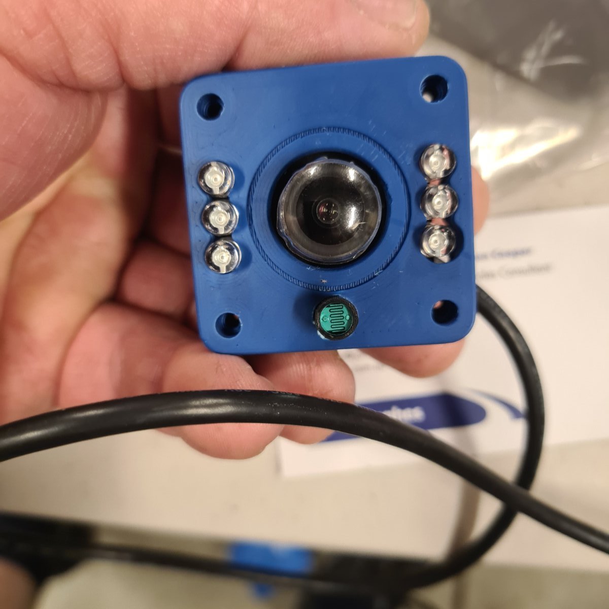

It says usb but I don't see the usb port on it ir do u have to make the usb for it

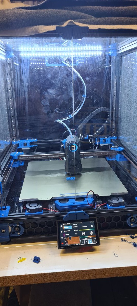

Chamber temps are coming up no the filter is not installed yet just sitting there as I cannot get the filter to print right looking at getting the re mix got some lights installed now so I can see as well got one more light to install will have 4  camera is on its way shoukd have that next week hopefully will start re doing the abs config next week as it is printing like crap on larger prints

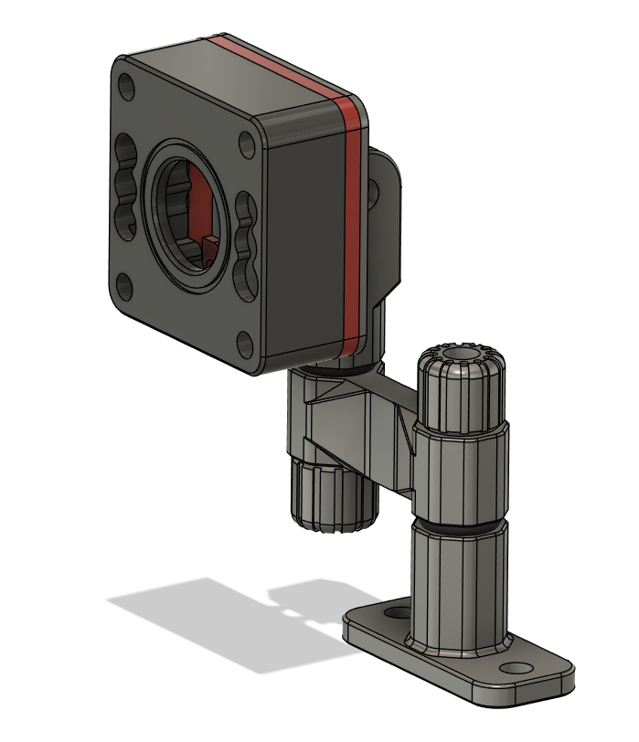

This is the Voron 2.4 mount I created for the ArduCAM.

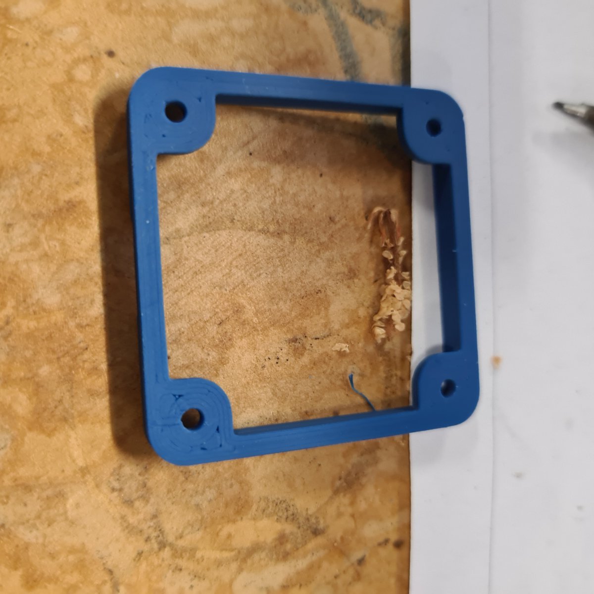

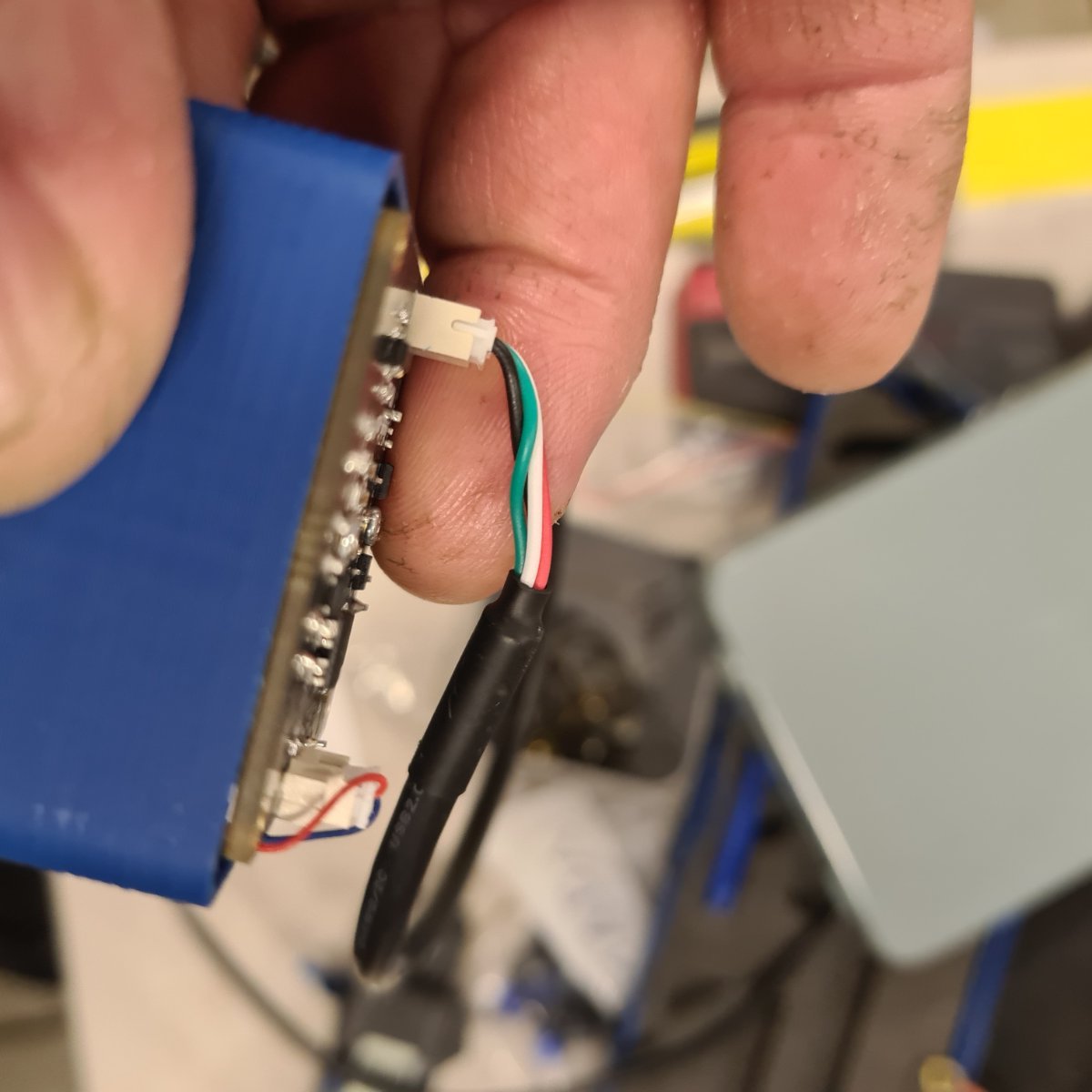

Just found out looks Like I have a slightly different model camera and I am going to print a adaptor for the back had to drill a hole in the front of it will send a pic once I make the adaptor I will send you the file as might be worth u keeping
Going to make a 10mm spacer to fit on the back of the blue square to allow clearance for the cables and have a hole at on end or slot to allow cable to come out then the normal backing plate will fit on
Camera is a ArduCAM  uc-a53
Rev.e
Yeah, your camera has the connectors 90 degrees to the one I was using.
Here's the Fusion CAD file if you want to try making some changes.
LL_GoPro 2020 Mount-Articulated_PK v9.f3z

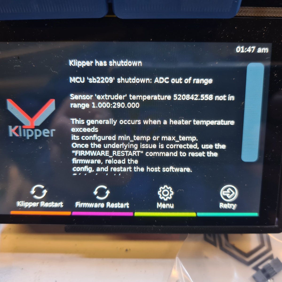

Um help so i disturbed my can cable yesterday to try and i n stall the new umbilical support that i did not end up using as did not fit any way the pt1000 i have on my hotend the plug is a bit dicky and gave me a error any way had some new ones on order any they turned up today pt1000 pro so I installed one and still getting this error any ideas
So found the problem old thermister had broken wire and the adaptor to go from sb2209 to the plug they use on the thermister was broken new thermister is fine and fixed the adaptor as stripping that cotton wrapped wite is a pain in the ....
But is working now did a calabration now for the new thermister happy now
