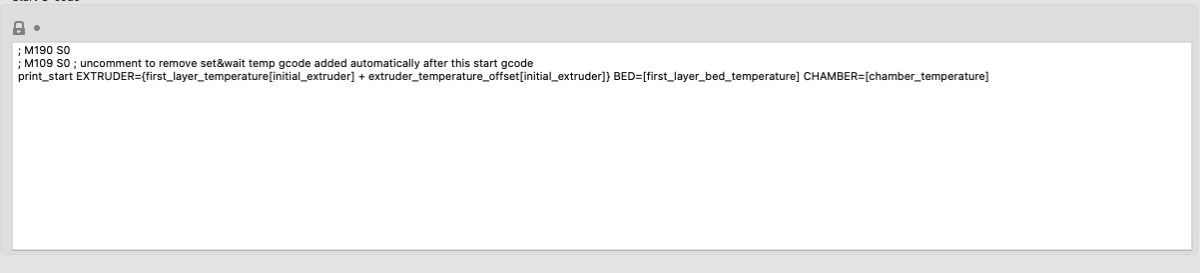

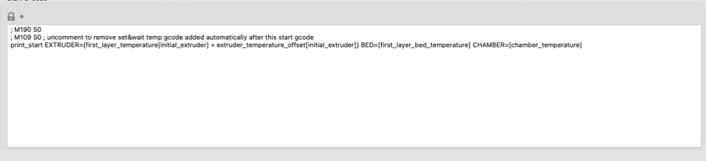

What slicer are you using? In the printer setting under custom G-Code enter the following. This should solve the hot end heating to 220C, cool to 150C, and back up to 220C.
; M190 S0
; M109 S0 ; uncomment to remove set&wait temp gcode added automatically after this start gcode
print_start EXTRUDER={first_layer_temperature[initial_extruder] + extruder_temperature_offset[initial_extruder]} BED=[first_layer_bed_temperature] CHAMBER=[chamber_temperature]
; M190 S0
Using orca and got the code in the tab same as @mvdveer said to put in and cannot that all of you enough this has and still is a big learning curve
Will give them.a try tonight

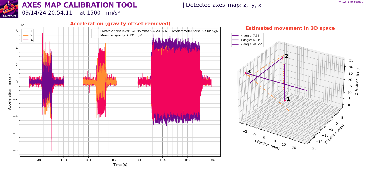

any one know how to setup adxl on the btt sb2209 rp2040 as i have no clue were to start
Add this to your printer.cfg file and change the probe points to the middle of your bed. (The below example is for a 350mm build\ for the SB2209 rp2040:
[adxl345]
cs_pin: EBBCan:gpio1
spi_software_sclk_pin: EBBCan:gpio2
spi_software_mosi_pin: EBBCan:gpio0
spi_software_miso_pin: EBBCan:gpio3
axes_map: z,-y,x
[resonance_tester]
probe_points: 175, 175, 20
accel_chip: adxl345
See this document for installation of the required software:
The run the command:
ACCELEROMETER_QUERY
You should see something like this if it is configured:
Recv: // adxl345 values (x, y, z): 470.719200, 941.438400, 9728.196800
Run the input shaper commands for X and Y.
Then enter the values into your printer.cfg file. Replace ... with the frequency and input shaper type
[input_shaper]
shaper_freq_x: ...
shaper_type_x: ...
shaper_freq_y: ...
shaper_type_y: ...

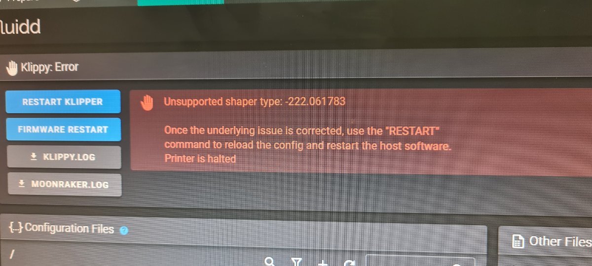

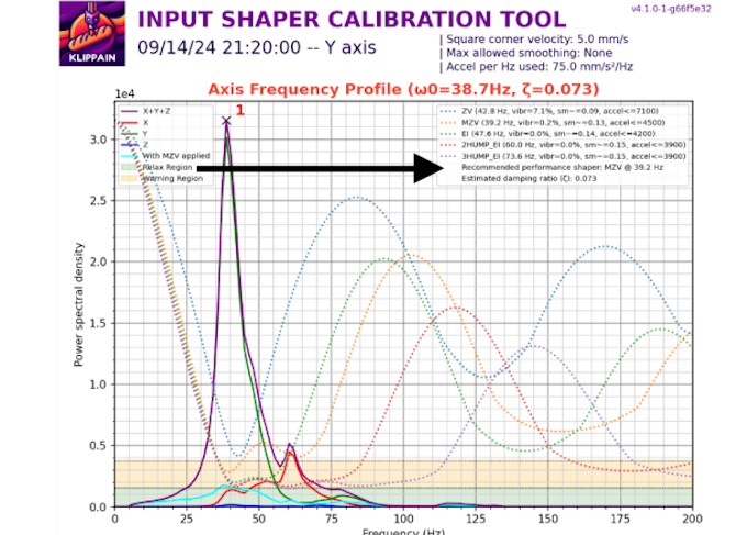

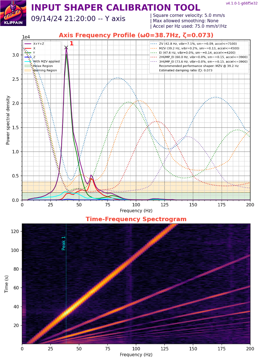

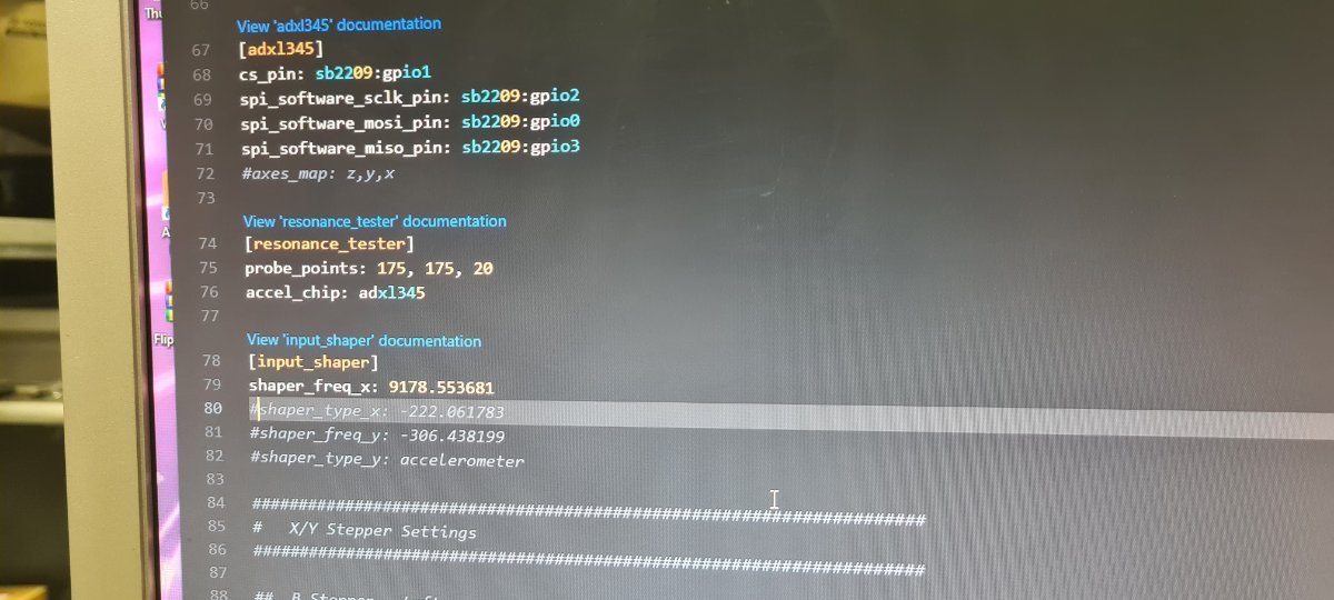

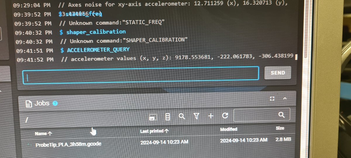

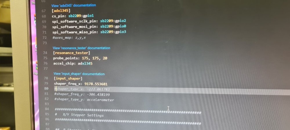

i am unsure how to config with the doc as it is canbus i did try klippain shake n tune but dose not seem to be right as the values are off x,y,z 9178.553681,-222.061783,-306.438199
klipper gets pissed with them
The error says "unsupported shaper type" and that is why.
You posted the resonances for the Y-axis thus your input shaper should look like this for Y:
[input_shaper]
shaper_freq_x: 39.2
shaper_type_x: mzv
shaper_freq_y: ...
shaper_type_y: ...

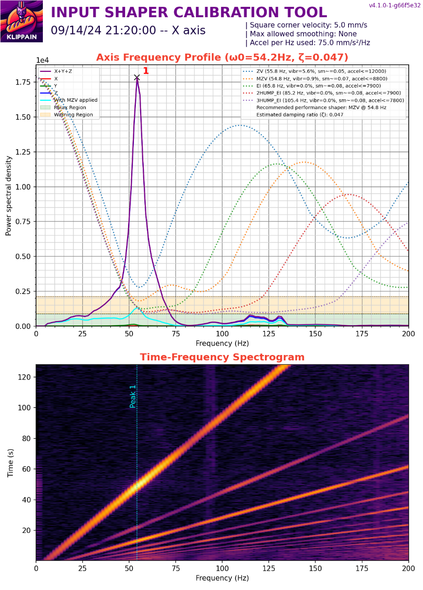

Get the values for X and do the same

Thankyou feeling bit silly atm did not read the bit about what shaper each was just the bottom one

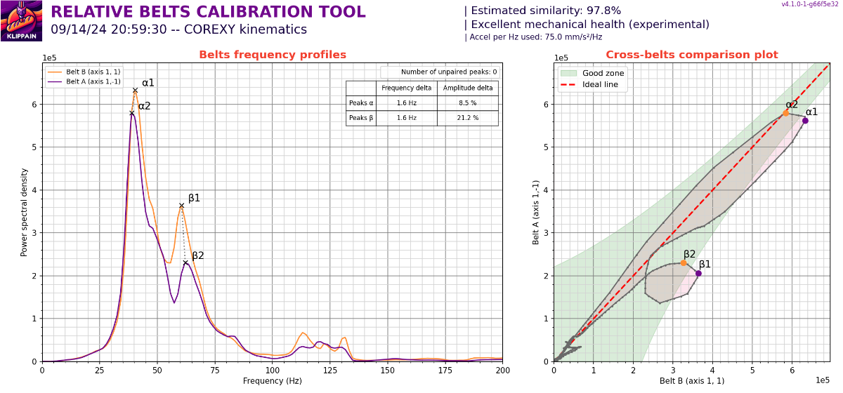

just updated shaper and doing my first lot of abs calabrations will reset klipper once the prints are done then i can print out my first lot of changes to my printer as there was a few things driving me nuts one beint the tooth head can supports hitting the cable chains and will be printing the ellis fan mods for under the bed as it takes forever to warm the chamber up

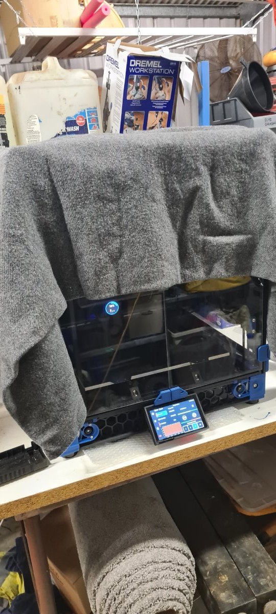

Sounds good so far I am running trialing hot end at 280 bed still 105 part fan off chamber temp is struggling at 35 now was 37 b4 but is slowly dropping I just threw a blanket over sides top and little over the front electronics fans still have heaps of room and temp is coming up a bit and print is looking ok so far will re do calabrations again as they are not right as the profile did not appear to be working and was cooling far to fast and getting poor prints but I will have a look at your settings tomorrow
