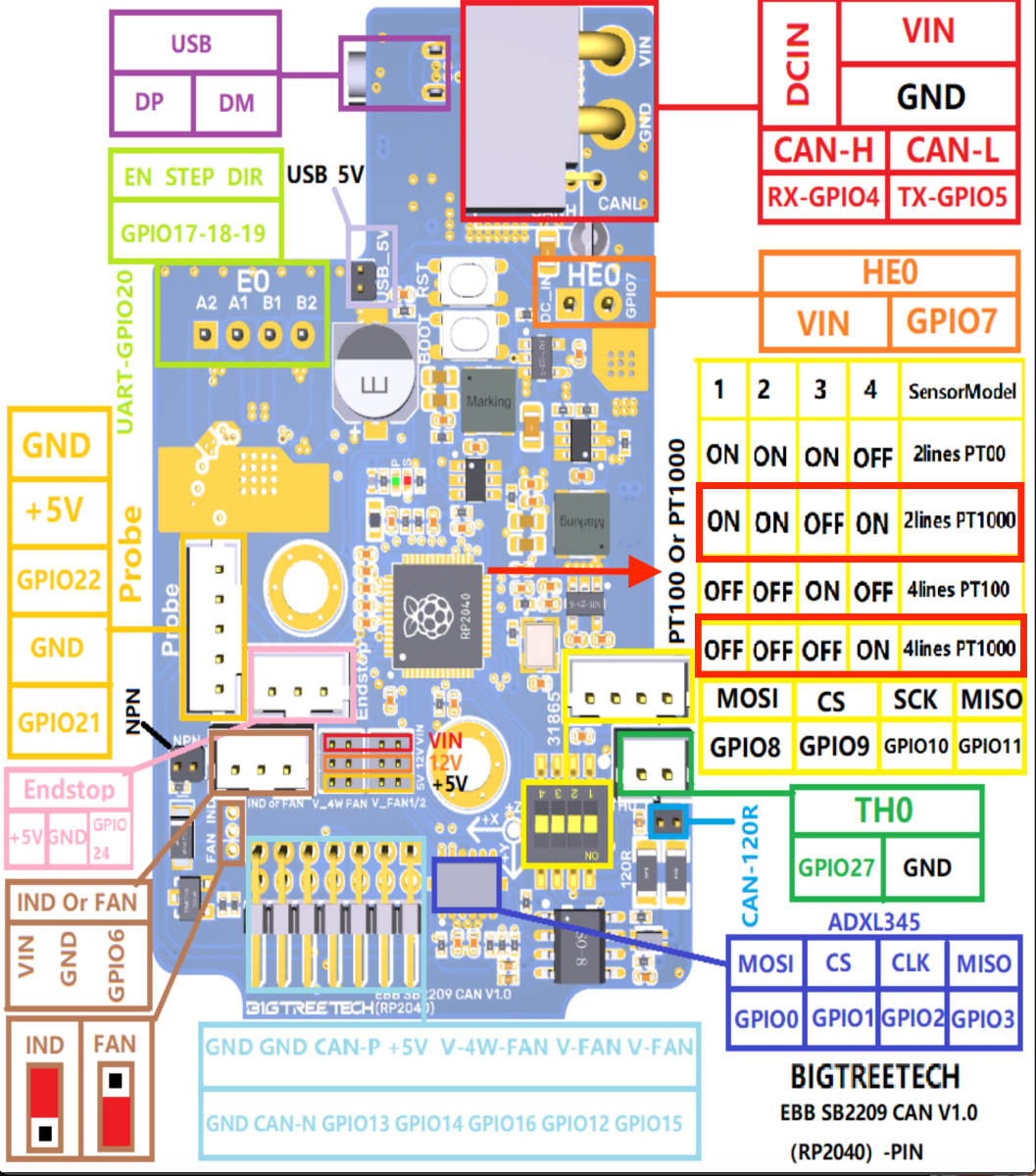

Need to have a look see if there is a 5v jumper or something like that for the sb2209 rp2040
Wouldn't be a jumper as your e-motor is connected to 24V. The only other thing is to make sure your PT1000 settings on the board are correct. They should be if the hotend is heating up.
5 hours ago, mvdveer said:
Try and invert the direction pin.
dir_pin: sb2209:gpio19 --------------->           dir_pin: !sb2209:gpio19
Yeah is spinning now I had a look at the z3 pin out ! Etc and was ! Onthe enable pin now is spinning so small win
Thankyou when I saw what u said above I thought I would look at how z3 was as it worked on there

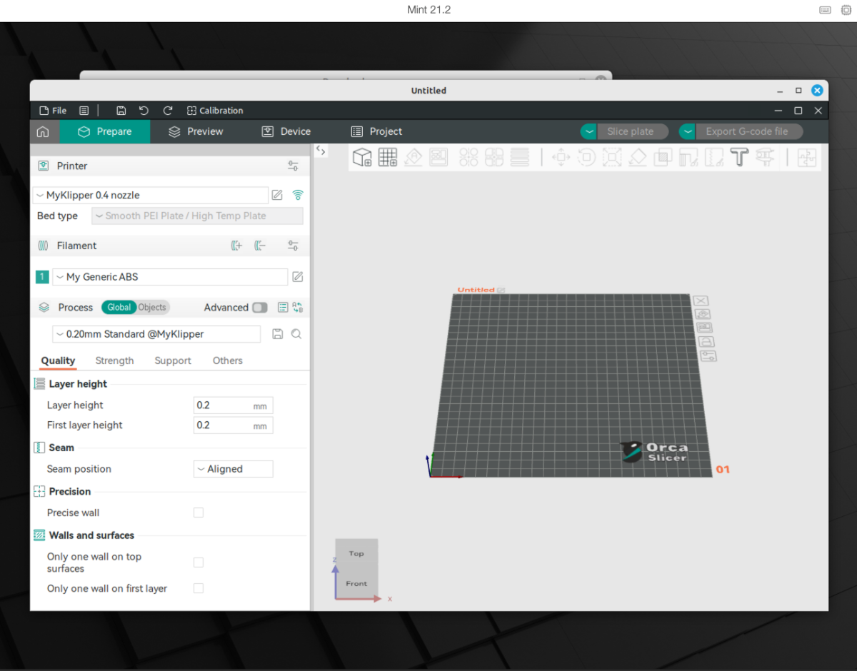

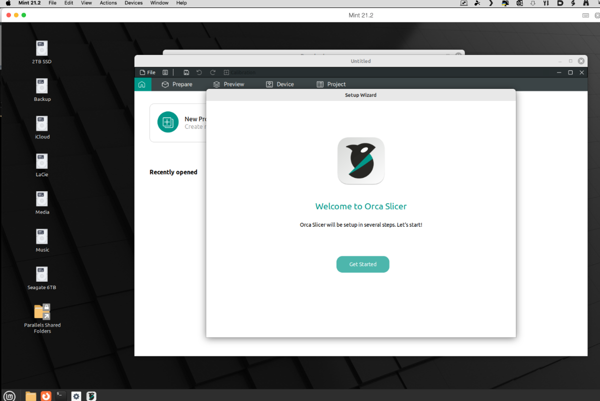

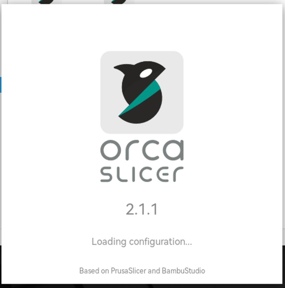

5 minutes ago, mvdveer said:
Installed mint in a virtual box on my Mac, downloaded Orca 2.1.1 and the result:
Seems to be working with the above steps.

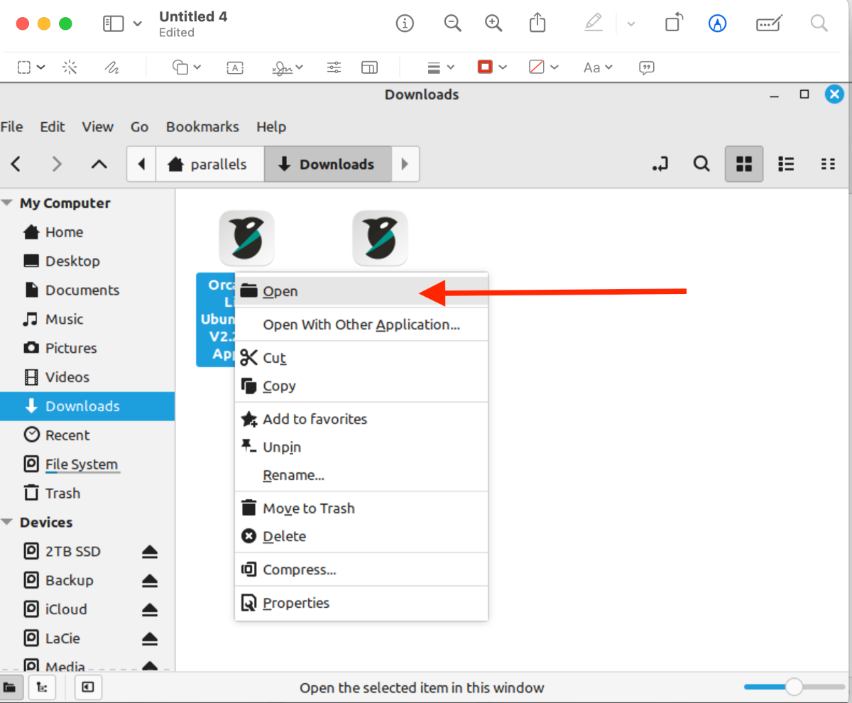

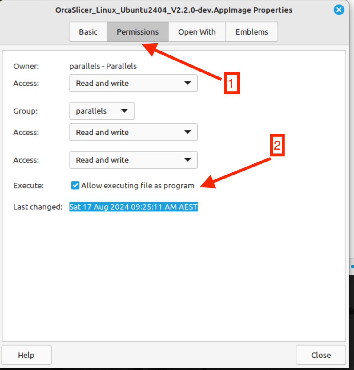

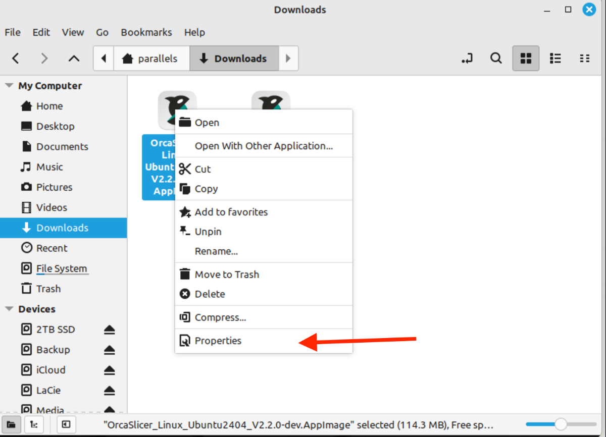

You don't install the AppImage. You need to make it executable.
Go to where you downloaded it.
Right click and select properties:
1. Click on the "Permissions tab then
2. Click the checkbox that says "Allow executing file as a program"
Click Close
Right click on the file again and say open
image.thumb.png.27afbcbb564ef3efaa62946ac18a0176.pngOrca should start:

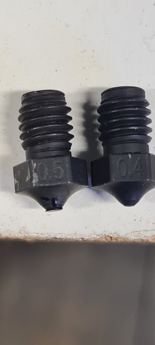

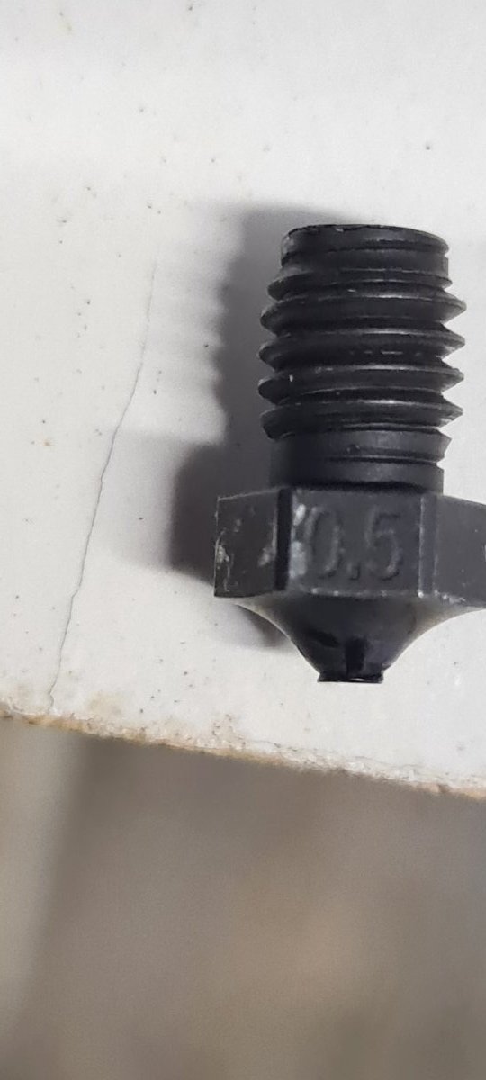

And can any one Id the second nozzel I thought it was a .5 but I don't see a listing for one the other is a .4 and is it the v6 or something else
