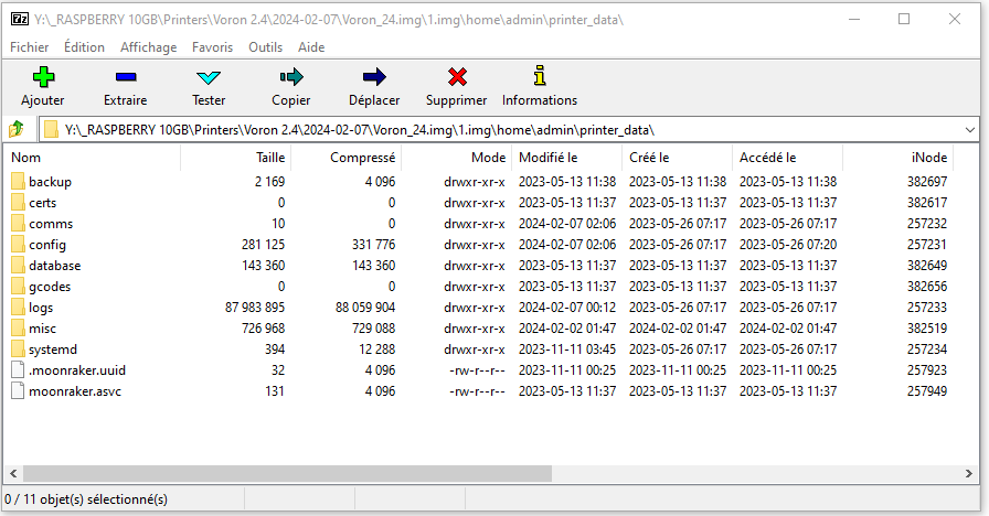

My story isn't so good - I guess I wasn't one of the lucky ones. The updates went well, mostly, and I had to change some parameters for deprecated things but that wasn't a big deal. I thought I was done yesterday and shut the printer down. I have yet to print anything yet.
Today, I get <this problem> and the printer won't start. But if I hook up a keyboard I can press "ctrl-D" to continue the bootup process.
The Klipperscreen shows me data from Klipper and I can run a full QGL and auto-z without any issues.
But when I try to connect to Mainsail via my laptop - it's dead and isn't running. I did get a bunch of "Moonraker" errors on the BTT on the printer about deprecated parameters, which I was trying to correct, but my ssh to the Pi works for about 2 minutes then kills the connection. On top of that it's very slow to respond.
I think I'm screwed and will need to reimage a new Pi SD card and start over, which I am not looking forward to. I have copies of the SD card and all my configs, but I'm sure there were other things I installed that I have to reinstall. It just seems like a daunting task at the moment.

Or maybe reading the SD card from a (virtual) Linux machine.
Another way to read a Pi card, without risking overwriting something while booting Bullseye + Klipper :
- image the card (I use Win32DiskImager, it is a old trustable portable utility that works fine)
- open the image with 7zip (it reads linux partitions)
This way it is possible to backup the card, and read it under Windows, without any risk os overwriting it. On my side I have a virtual Ubuntu and both 7zip and Win32DiskImager.

@YaaJ Thank you that seems like a good idea -- however I can't seem to get 7zip to open my image file that I made earlier.
https://superuser.com/questions/1508879/opening-dd-image-in-7zip
That says that it won't read ext filesystems (I think the Pi would use ext3 or ext4) but I'll keep trying. When I open the image in 7zip it just gives me a file called 1.img and that file can't be opened by 7zip, even if I extract it to my desktop and try opening it from there.
I'll keep looking at it. Maybe you can check which version of 7zip you're using?
Otherwise I'll just power up the Voron and fetch things via FTP since the system comes up. I also have backups of my configs so it's not a big deal if I can't read the image.
As you can see, it is an old version. If you can't find it, and want to test, just let me know. 1.5 MB only, will PM to you...
It opens 1.img just fine...
No knowledge at all about the Linux filesystem, and one day discovered 7zip opens images because of the Windows contextual menu... ; gave it a try, and bingo !
For imaging, I use Win32DiskImager, that creates ISOs. I first reduce the parttition with gparted, from a Ubuntu virtual machine, then image it under windows (option "Read Only Alolocated Partitions" being checked, so the unallocated space doesn't take room in the ISO), and finally re-expand the partition with the virtual Linux, or with raspi-config. Takes less time that one could think. Saved my life many times, since Octoprint. Can access any older config file or flash a known good OS at any time from the backups RAID.
[EDIT] if the partition can't be read, maybe it means it is corrupted...
[EDIT 2] do *NOT* resize the partition if you suspect a problem, as it rewrites sectors
