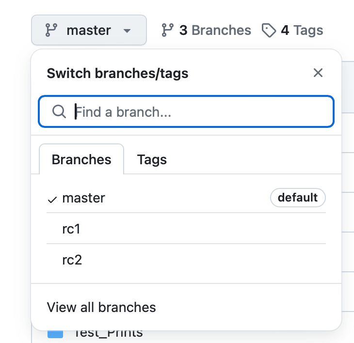

There is a branch for rc2. The readme of that branch still shows rc1, but the files in there are rc2. Maybe still in beta and not merged to the main branch as yet?

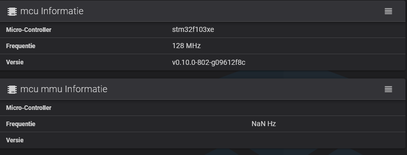

The above i've al done , flashed the BTT MBB ..it shows up as usb-Klipper_stm32g0b1xx_3F0039001950425539383920-if00
But in Fluid I cannot seem to get connection with it .
Yes I've adde it in printer.cfg and mmu.cfg   still nothing.
What am I doing wrong ?
I can see my printer has a -port0 behind it ( usb-1a86_USB_Serial-if00-port0) and show up in Fluid (and working before and when I grey out the mmu)
Does the BTT MBB als need a port? and how to

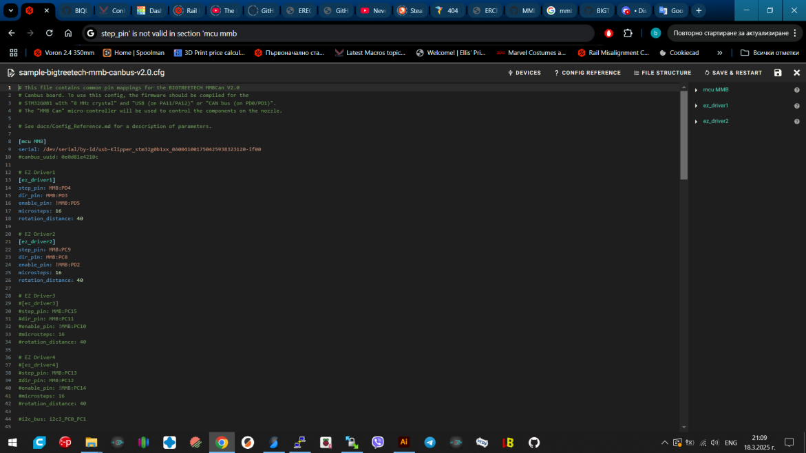

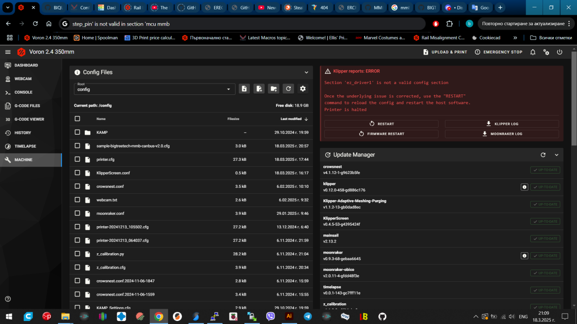

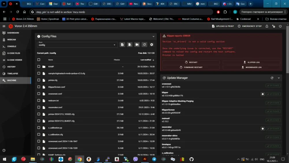

Hello, I'm trying to set up ERCF and I have a mmb can v2.0 board, I installed everything, but I got to the point of configuration, but I have a problem because it tells me that the drivers, which are EZ5160Pro, need to be configured, but I can't find any information on how to do it. Would anyone be willing to help me with the setup in e sample-bigtreetech-mmb-canbus-v2.0.cfg, because I don't have much knowledge in this area, thanks in advance
