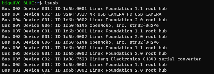

In addition to the command you ran you can run an `lsusb`. It'll show all currently attached USB devices.
If the device has been correctly flashed and reset it'll show up as something like `OpenMoko, Inc. stm32f042x6`
If it either isn't present on this list or still listed as `in DFU Mode` then there's something up with the device.

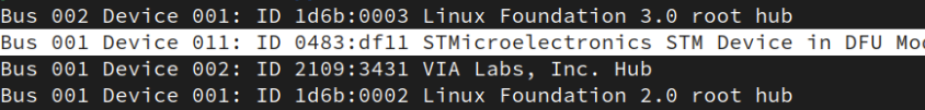

I can get it to show up in DFU mode, if I then remove the jumper and do a reset it does not appear.

It showed up (with lsusb) as  OpenMoko stm32f042x6 and the red LED was on, I rebooted and now it still shows up with lsub but there's nothing on the display.
