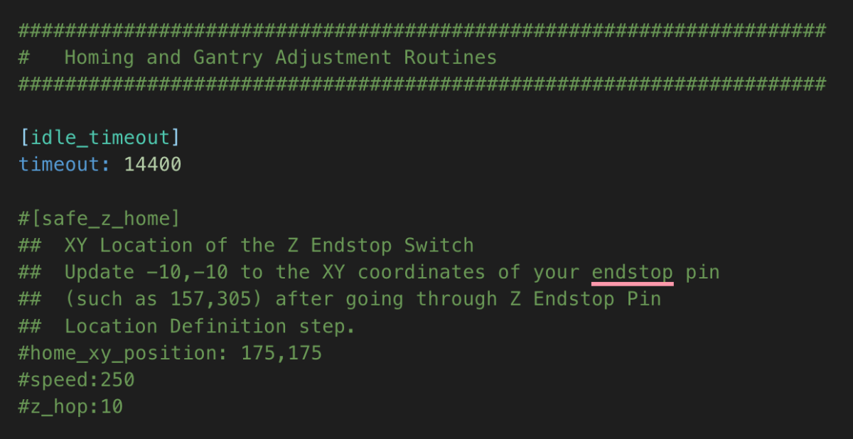

I have not noticed any question marks after a G28 or a bed mesh. But the z-motors turn off after a while. Once the z-motors turn off, the gantry will not be level anymore and you will need to do a g28 again.
I did some testing and after being idle for about 3-5 minutes all 3 axis turn off, kind of like a power saving feature.  I just run the axis around for 10 minutes with no issues.  I am just waiting for more wire to arrive then it shouldn't take too long to melt plastic.
  • 0
feature of Klipper.
In my printer.cfg file I have this constant:
[idle_timeout]
timeout: 1800
I guess that is seconds. so in my case it is 30 minutes. And here is the Klipper reference in case you are interested 🙂

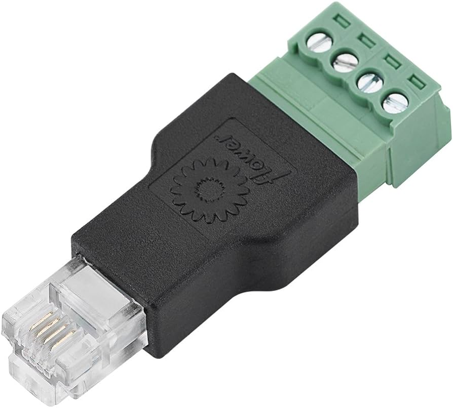

@madmike46 when you decide to go with Canbus lot of use use this terminal block to connect the H&L wires to the Octopus Canbus port (RJ11). Trim about 2 or 3mm of the black plastic around the RJ11 connection side. This will allow the block to seat properly into the port.

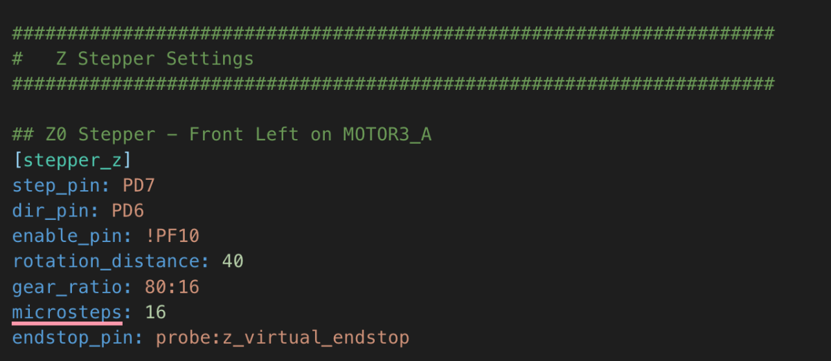

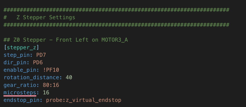

On 1/2/2024 at 6:25 PM, madmike46 said:
I'm using Bigtreetech'sEBB sb2209 rp2040.  I will look at Dirk's links, I still like the idea of only 4 wires going to the tool head.  I did get my Tap working today as well as QGL.  Been saving my printer config file after every success.
Im having issues with the same setup. my tap is not triggering. how did you solve this?
  • 0
Have you sett the endstop pin for Z to probe:z_virtual_endstop
You also need to comment out "safe_z_home"
