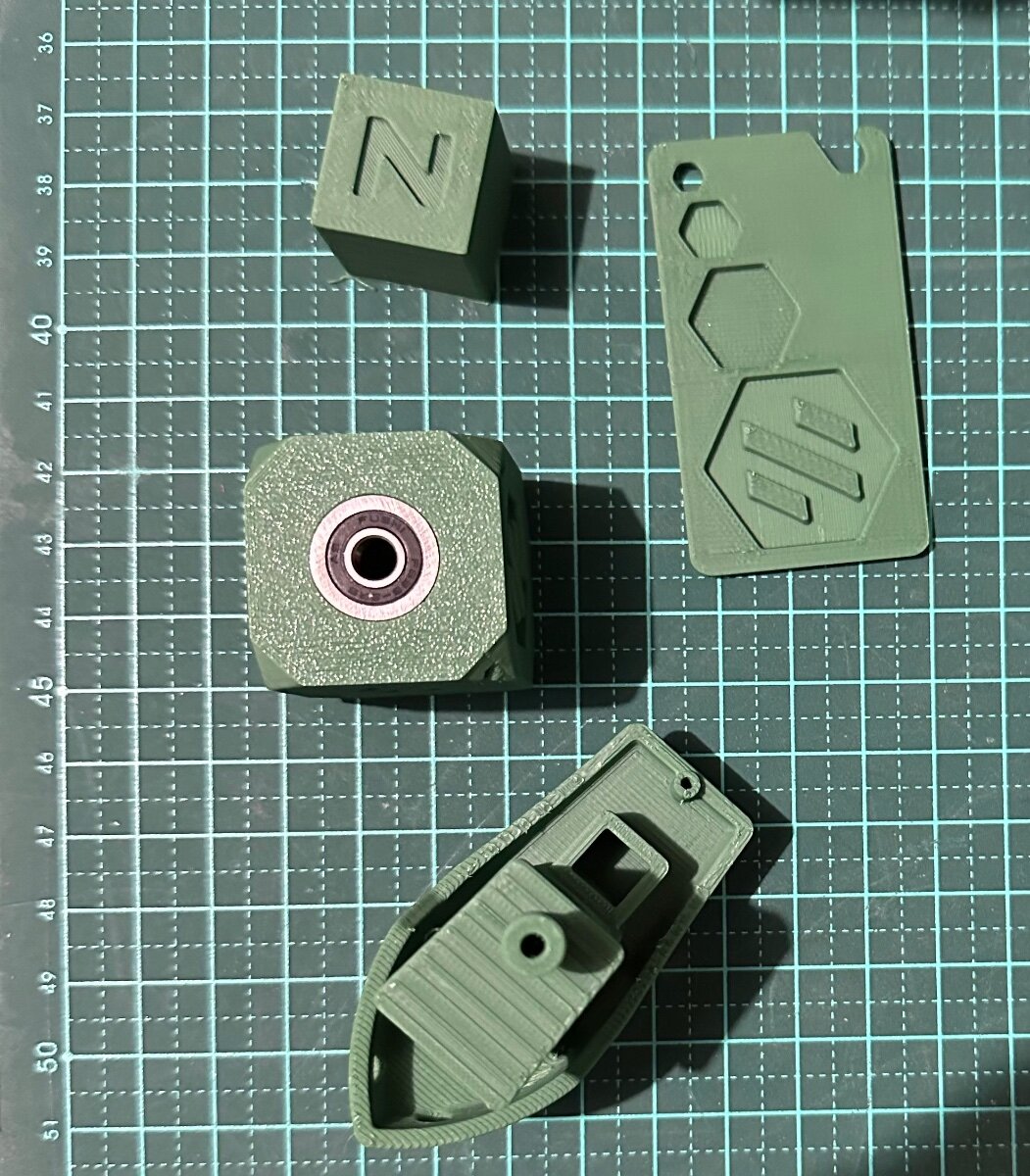

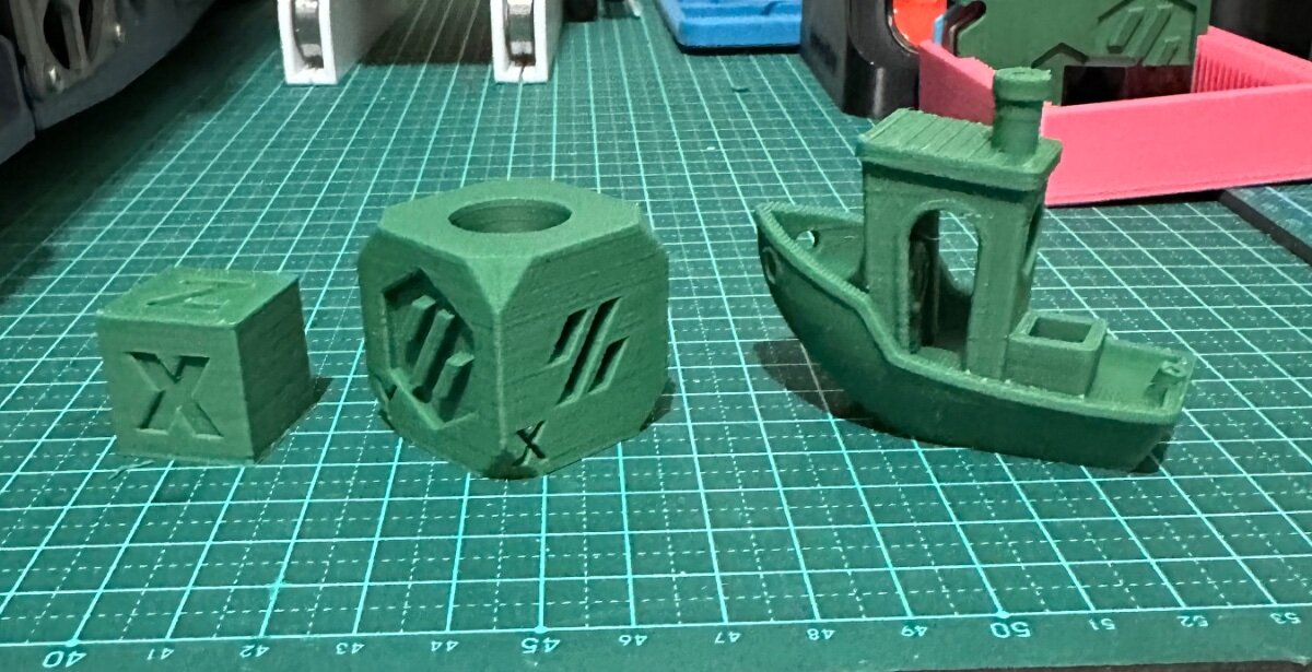

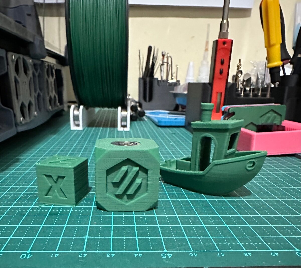

Think I got the printer tuned to a point where I can print with reasonable accuracy and decent prints. Still have to do resonance Tuning. These are the results so far:
IMG_3704.thumb.jpeg.10ab5f495b264bcc3c60f6914f6b2d26.jpegIMG_3708.thumb.jpeg.218efe5d86b225d955ab199e0eb0814c.jpeg

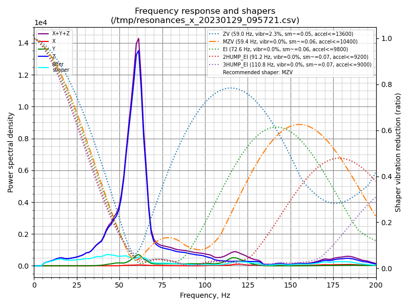

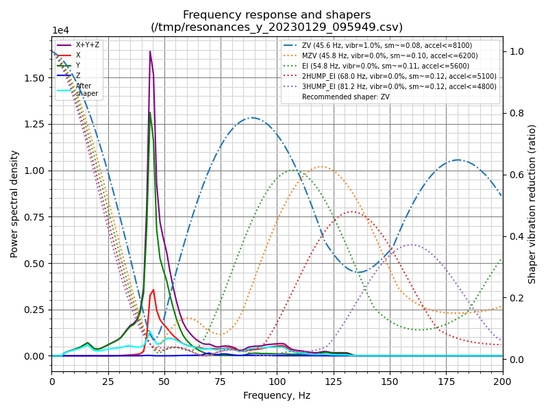

Having read of all the shutdowns with resonance tuning and the SB2040 Canbus - that will be the challenge today
4 hours ago, smirk said:
Well done, everything looking really good. Out of interest (since the MCU did not bork with resonance tuning) what "speed" you running the canbus at ?
Set it up as 1000000. Has been working well so far
