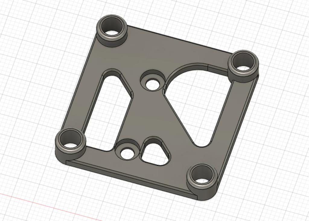

LGX Lite CAN Side Mount (Huvud/SHT42)
Side mount for CAN toolhead boards with NEMA 17 sizes such as Huvud and FLY-SHT42.
You will need two M3 square nuts that should have come with the LGX Lite to put into the side holes for mounting.
I am using this on my Voron 2.4 with Mrgl-Mrgl's LGX Lite Mount for the extruder.
BOM
- 4x M3 Square Nuts (Included with LGX Lite)
- 4x M3 Heat Sets (Standard Voron Spec)
- 2x M3x6 BHCS to mount through to LGX Lite holes
- 4x M3x6 SHCS for board mounting (or whatever is suitable for your board)
