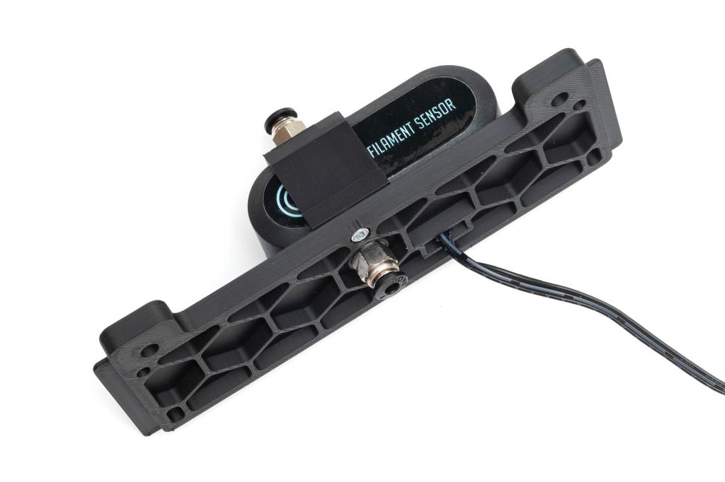

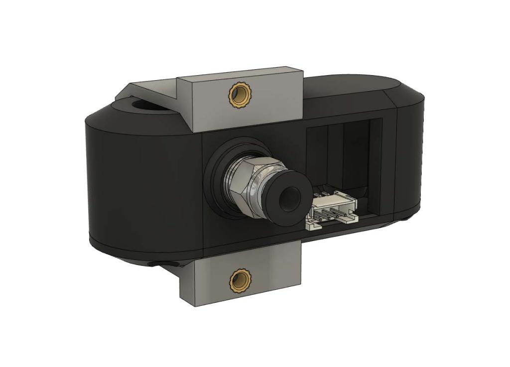

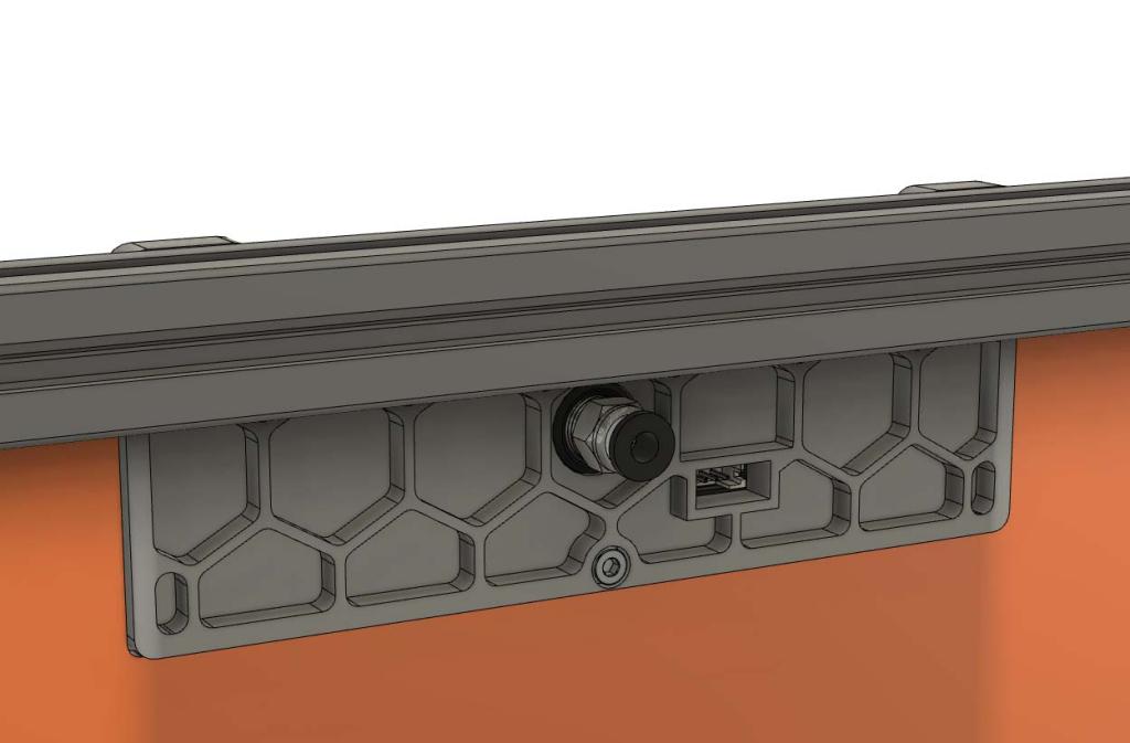

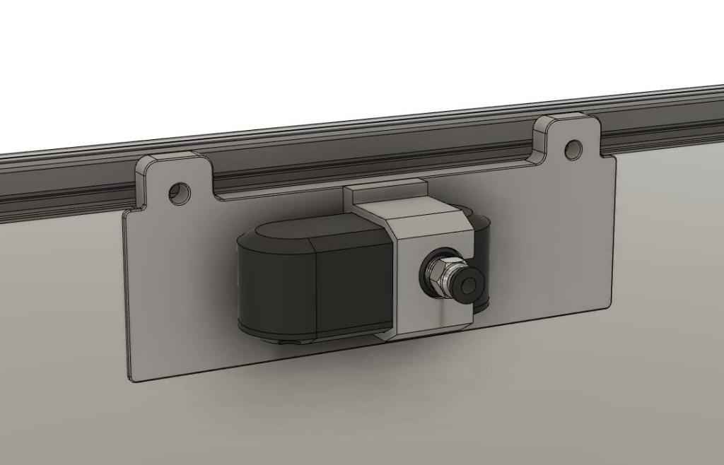

Voron V2.4 exhaust cover and BTT Smart Filament Sensor mount
The STLs will work with 3mm foam (compressed to 2.5mm) but other thicknesses are possible
The same cover without the filament sensor mount https://github.com/Autocrit/VoronUsers/tree/master/printer_mods/Fiction/Exhaust_cover
Design influenced by https://github.com/VoronDesign/VoronUsers/tree/master/printer_mods/falo/magnetic_grill_cover

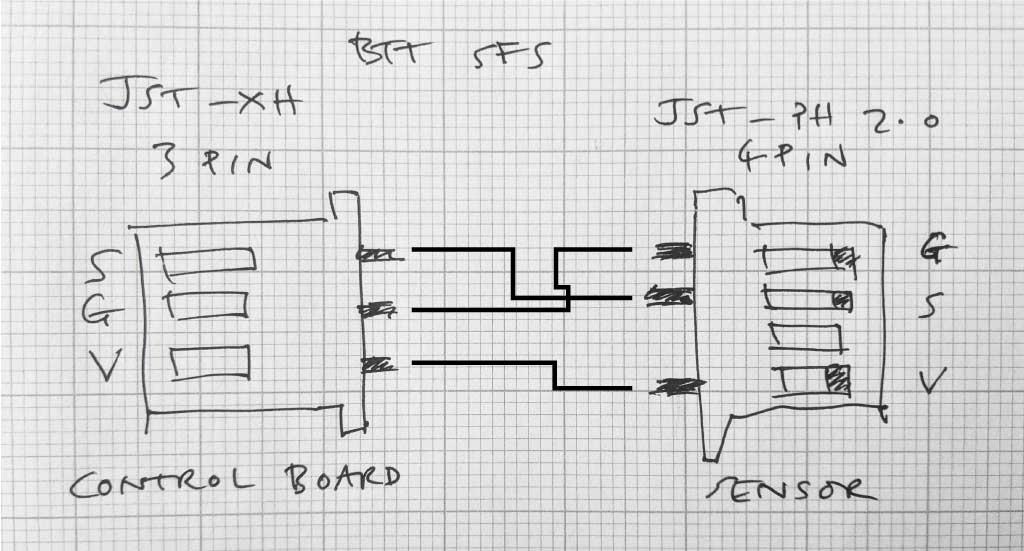

BTT Smart Filament Sensor wiring

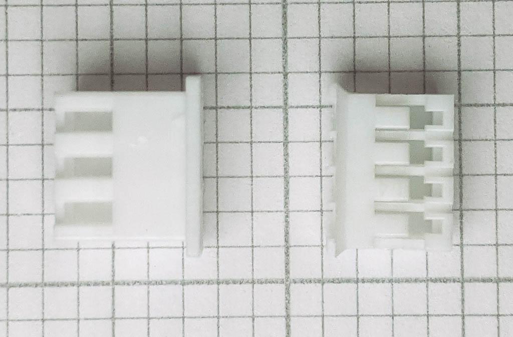

The supplied cable works as-is with the Fysetc Spider V1.1; I'm using it on Y-MIN which is PB13. A longer cable might be required in which case a 4-pin JST PH 2.0 connector is needed for the sensor end, and a 3-pin JST XH connector for the control board end.
