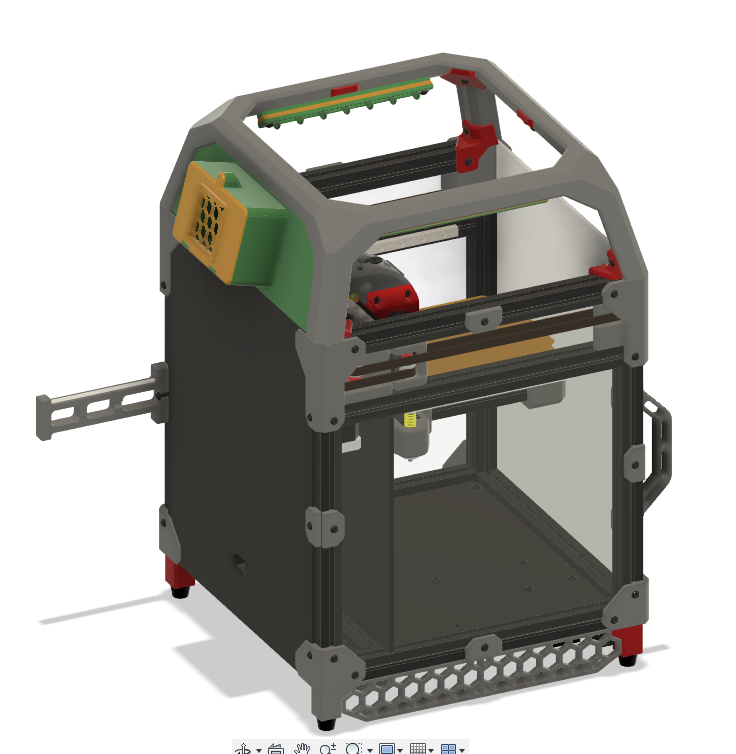

Voron V0 Exhaust and LED Mod
No stink, good light
Since the lack of suction on the VO bothered me and, in my opinion, printers should always have light, I developed this mod.
- no more stink
- bright, even light
- Extraction even without LED lighting

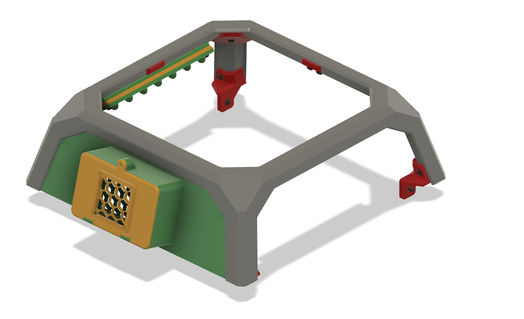

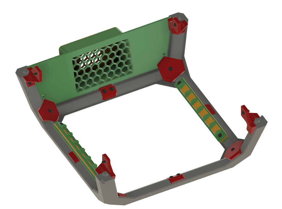

BOM
Exhaust
- 1 (5 optional) Heatset Insert M3
- 4 Nuts M3 (optional)
- 1 Screw M3x8 BHCS
- 1 Fan 40x40x X (10 or 20mm tail)
- 4 scrwe M3x X (depending on the fan)
LED Light
- 4 Heatset Insert M3
- 4 Screw M3x12 BHCS
- 4 Screw M3x10 BHCS
- 2 x 10cm LED Stripe 24V 60LED/Meter
