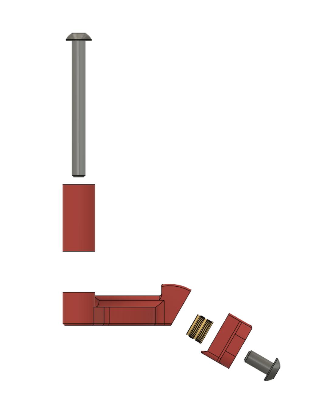

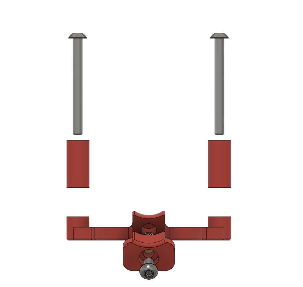

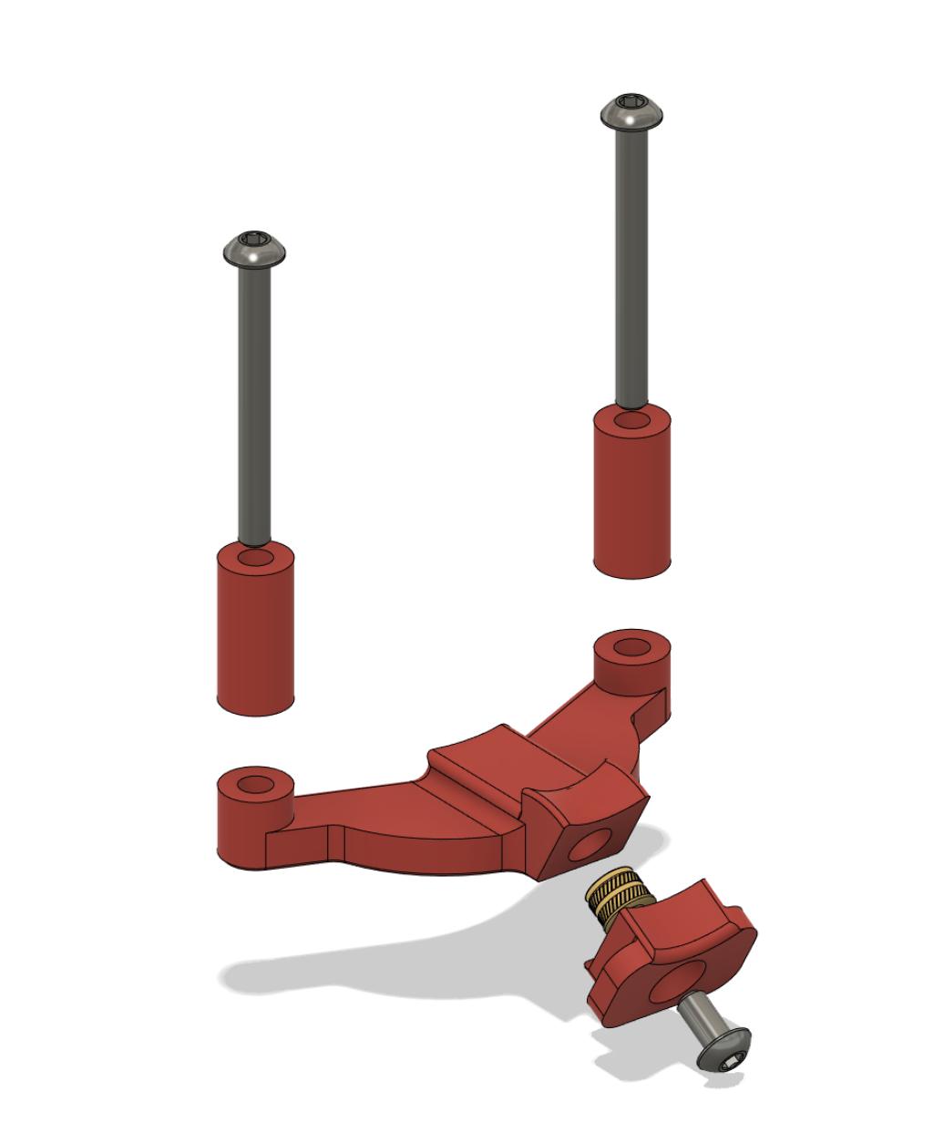

Instructions
- Install the M3 heat-set insert into the top of
Strain_Relief_Body_x1
. - Use the M3x6 BHCS to attach the
Strain_Relief_Body_Top_x1
to theStrain_Relief_Body_x1
- Insert the 2 M3x30 screws from the front of the toolhead, through the motor,
Strain_Relief_Spacer_x2
andStrain_Relief_Body_x1
finally securing them with M3 nuts on the back of the strain relief. - wires can be routed between the motor and the strain relief, through the recessed area.
